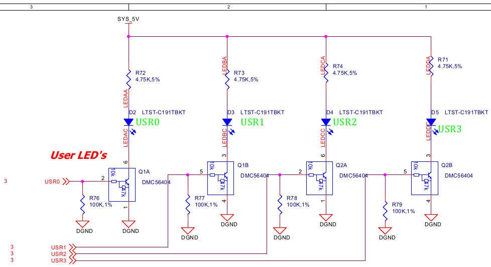

Howdy...
I'm trying to make sense of the Datasheet for the AM3359 and it seem to me the GPIO is limited to 6ma (some even 4ma) each and 100ma total (on VDDSHV6).
So it seem to me that I should really buffer the I/O and not drive an LED straight from a GPIO pin...
Am I reading the Datasheet properly ?

    I think you are reading it correctly. Most LEDs can be driven brightly for indication with just a few mA, so in that case you should be ok - I've not fried my BBB with just a few LEDs (see here) and neither has this guy here. For higher loads, driver circuits should be considered.

    I don't disagree, leds with suitable resistors will be fine.
    However, for comparison, page 6 of the BBB schematics has this for the onboard leds.

    Hehe yes I too noticed that. Nice little 6-pin devices for Q1/Q2. I wasn't sure what voltage blue LEDs need (not really something either of us use a lot of! ;-)
    Which reminds me, I still need to remove them off another BBB. I might go for sunflower yellow this time ;-)
    0 e14 Contributor over 12 years ago in reply to shabaz
    I recall the voltage is slightly higher, but not much.  I think they did it this way so that they could make those blue leds really, really, really bright image

    According to Wikipedia, Blue LEDs have a voltage drop from 2.48V to  3.7V.  I've usually seen numbers like 3.1V.  It's problematic driving these from 3.3V, since the chip will only be able to pull down to 0.1V to 0.2V or so, so good luck selecting a resistor to get just the right amount of current.
    So the board pulls the blue LEDs up to 5V.  The problem here is that if you connect the LED cathode to a SoC GPIO, if that I/O is off the LED can pull the pin to 5V and blow the I/O if it's not 5V-tolerant -- I think only the USB pins are 5V-tolerant.  If you're lucky, the GPIO's VDD clamp will turn on and the LED will turn on weakly.  I think the transistors are there to protect the SoC pins.
