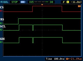

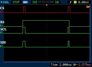

    shabaz over 11 years ago in reply to mcb1
    Hi Mark!
    No it isn't, but as far as I can tell that is a zoomed-out view showing two bytes (or more - not sure), so the screenshot is very unrepresentative of the detail. I think zoomed-in we would see the detail.
    mcb1 over 11 years ago in reply to shabaz
    IS it right that SCL and SDI are exactly the same ??
    shabaz over 11 years ago in reply to koolkat204
    I think you must be close, certainly all the signals are functioning now, but hard to say what could be the issue : (
    Is there no chance of replacing your OLED with the same model that I used?
  • koolkat204
    koolkat204 over 11 years ago in reply to shabaz
    Hey shabaz,
    Made the changes and still no luck. Here are some zoomed in screen shots.
