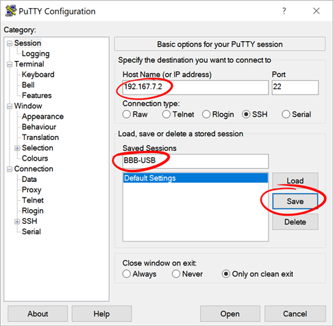

The BBB will have an IP address of 192.168.7.2. You can connect to it using SSH (e.g. with PuTTY software on Windows, or using the in-built SSH command line client on Linux or Mac, by typing in a terminal ssh debian@192.168.7.2 ). The username and password are debian and temppwd respectively.

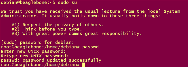

Creating a Superuser Password
To create a superuser password, type:
sudo su
Enter the default debian user password (temppwd when prompted for a password. Next, type
passwd
and enter the desired password.

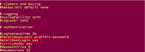

If you wish (it can be considered a security issue), you can allow direct SSH access to the superuser, by editing the /etc/ssh/sshd_config file. There will be a line with PermitRootLogin commented out (prefixed by a hash or pound symbol). You can either change that line, or add a new line, with the following text:
PermitRootLogin yes
Save it, and then type:
systemctl restart ssh
You’re now a superuser, and can proceed with the remainder of the housekeeping stuff described below.

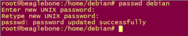

Changing the default debian user password
Now that you’re a superuser, you can easily change the debian user password from the default temppwd to something more secure.
Type:
passwd debian

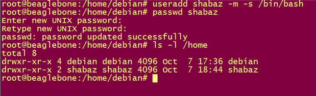

Creating a New User
Type (change bob to be your name):
useradd bob -m -s /bin/bash
Next, change the password using:
passwd bob
If successful, Linux will have created a /home/bob folder

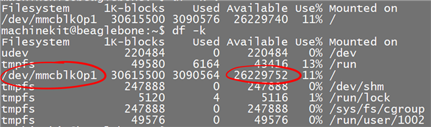

Increasing the micro SD Partition Size
The BBB only has 4 Gbyte of space on the micro SD card by default, due to how the image as downloaded from the BeagleBoard website was configured. This isn't a lot. You can see the free space by typing:
df -k
To configure the disk system to use all the space available on the micro SD card, type the following:
cd /opt/scripts/tools
./grow_partition.sh
It may return an error, stating Device or Resource Busy. Anyway, reboot the BBB, by typing reboot and wait until you can connect to it again.
To confirm that the partition size has increased, type df -k again.
There should be a lot more space free now! The example below shows that there are around 26229752 blocks of 1 kbyte available. That's about 26 Gbytes of free space (this example used a 32 Gbyte micro SD card).

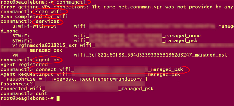

Connecting to a Wireless Network
If you’re using a BBB-Wireless, you can do this step if desired. Otherwise, skip to the next step!
The steps here will configure the BBB-Wireless to connect to a 2.4GHz wireless LAN (WLAN).
Type:
connmanctl
You may see an error concerning VPN. Ignore it, and at the new connmanctl> prompt, type:
enable wifi
scan wifi
services
agent on
connect wifi_xxxxx_managed_psk
Type the wifi password as requested, and then despite the prompt appearing, wait a moment for a Connected message. You may have to wait 30 seconds or so. Then, type
quit
To confirm the wireless IP address, type
ifconfig -a
Search for the text wlan0, and the IP address should be there, for instance:
inet 192.168.1.210
Now there is no need to use the USB cable for future connections. The wireless interface can be used instead.

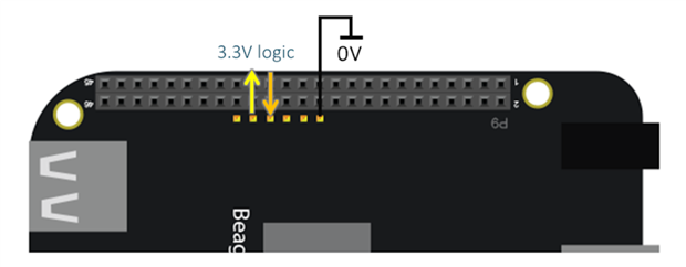

Problems? Use the Serial Console
If there is Linux install or connection issue, it is possible to see what the BBB’s bootloader is doing, and also how far Linux has got with its execution, by examining the serial console output. To do that, connect a 3.3V USB UART cable to the 6-pin header on the BBB (it may be labelled J1 on some BeagleBones. In any case, there is only one 6-pin header so it is easy to find). Pin 1 has a square solder pad on the underside, the remainder pads are circular.
The communications pins and direction of data is:
Pin 1 (the square solder pad on the underside) is 0V. Pin 4 receives data from the PC, and pin 5 transmits data to the PC.
A suitable USB UART cablesuitable USB UART cable has six pins. Four of them are used. Connect the black, orange and yellow wires as shown above. There is also a red wire that needs connecting to 3.3V.
If your USB serial interface needs a 3.3V power source, or needs to see a voltage to identify the logic levels, then connect that pin to the 46-way P9 header pin 4 (for convenience, you may wish to permanently solder a wire on the underside of the BBB, from P9 pin 4 to the 6-way header pin 2, since pin 2 is not connected to anything).
On your PC, use serial communication software (PuTTY can be used for this) and set to 115200 baud, and then power up the BBB. You should see some output, and hopefully it can assist in troubleshooting.
