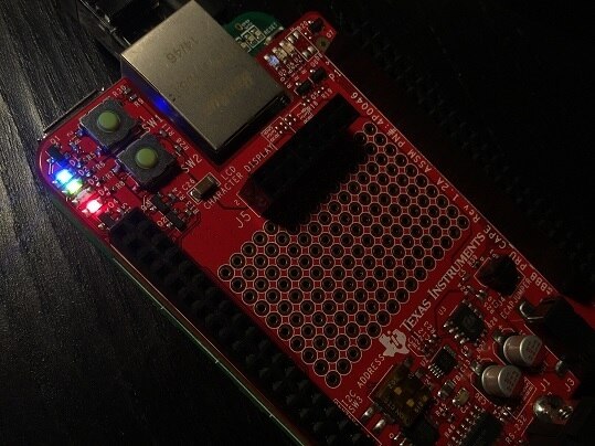

I'm selecting PRU GPIO pins 29 and 31 - because I have a cape that has LEDs on these pins that make it easy to see the effect.
But any PRU accessible GPIO pins can be used.

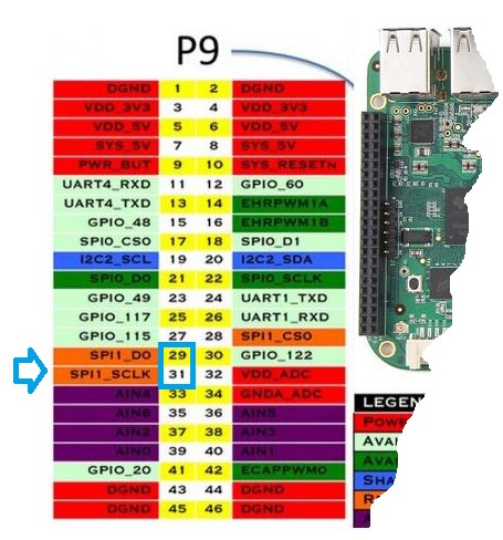

MUX Outputs for PRU
There are several ways you can define the pin mux. I'm using the Linux driver to do that.
These are the two pins I'm using:
  • PR1_PRU0_GPO0: P9_31 (blue LED, symbolically represents the DIR signal)
  • PR1_PRU0_GPO1: P9_29 (green LED, represents the STEP signal)
image source: modified from seeed wiki for the BB green
These Linux commands reserve them as PRU controlled output pins:
config-pin P9_31 pruout
config-pin P9_29 pruout
The PRU can now address them and drive them high and low.
When finished at the end of the program, best assign them back to their default muxing. Else the PRU driver complains after reboot.
config-pin P9_31 default
config-pin P9_29 default

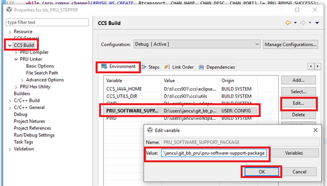

Code Composer Studio project attached.
You need to download TI's LABs, they contain some dependencies we need.
In the project's properties, adapt the variable PRU_SOFTWARE_SUPPORT_PACKAGE to the home location where you saved the LABs.
