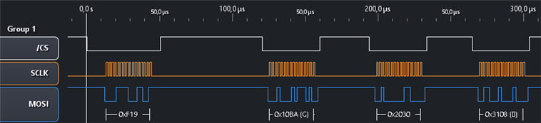

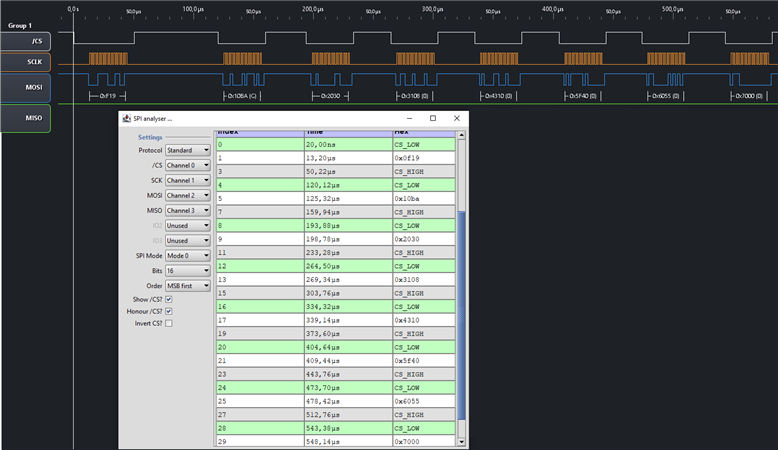

Here's the result captured by a logic analyser. The CS is not correct. The grab was made before I corrected the CS polarity.
I have the advantage that I've captured the traffic before on other microcontrollers. I can compare and validate.
The results are as expected.
