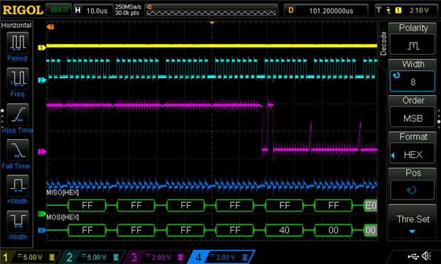

I used the test program spidev-test to check it, and it works.
You need to bridge the MISO and MOSI pins (P9_18 and P9_21) to test this program.
debian@beaglebone:~/bin$ ./spidev_test
spi mode: 0
bits per word: 8
max speed: 500000 Hz (500 KHz)
FF FF FF FF FF FF
40 00 00 00 00 95
FF FF FF FF FF FF
FF FF FF FF FF FF
FF FF FF FF FF FF
DE AD BE EF BA AD
F0 0D
The utility send a set of data via SPI MOSI and shows what is detected on MISO. Because they are bridged, the output equals the input.
image the spidev-test program in action
The cope capture below shows part of the communication.
The 4th channel, MISO, shows nothing because I had not bridged the input to output for this capture.
If I would have done that, you'd see a trace identical to channel 3.
The decoder would then show the identical data for MISO as it does for MOSI.
