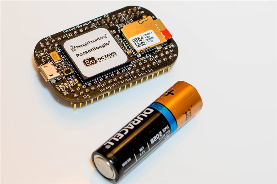

The PocketBeaglePocketBeagle single board computer (SBC) is really tiny. Apart from the size, there are lots of similarities with the larger BeagleBone BlackBeagleBone Black, and there are also some differences.
In terms of performance, it is identical. It has the same amount of memory, and runs using the same processor and the same Linux image too!
To get the size down, it is of course missing many connectors but a lot of functionality within the main chip is brought out onto the two 36-way pads (no header pins are supplied but two of these 36 way header pins36 way header pins will fit). It isn’t possible to attach HDMI displays, because the BeagleBone Black used a separate chip for that on-board, and that is not present on the PocketBeagle. Also, unlike the BeagleBone Black there is no eMMC storage on-board, but often the BeagleBone Black eMMC lays unused, because people may just stick a larger Linux image onto a Micro SD card.
Just like the BeagleBone Black, it is possible to power it from a Lithium Ion battery directly, and it can charge the battery too. This makes it great for portable applications. There is a built-in power button that could be exposed through an enclosure if desired.

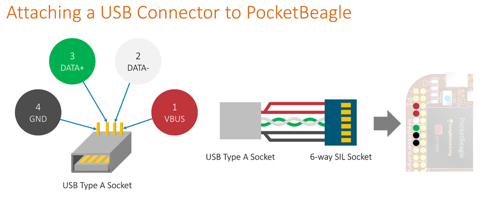

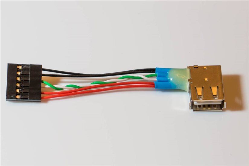

To do that, obtain a USB socket and wire it as shown in the diagram.

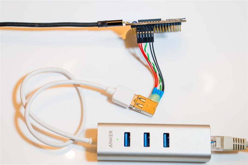

Plug the connector to the PocketBeagle header P1 pins 5,7,9,11,13,15 (they are all together in a row) and then plug in your USB device, and then power up!
Note: this is a hack, a proper way to do it would include circuitry for overload and ESD protection, and to enable/disable the power under control of the USB driver. However for development purposes while you are creating your PocketBeagle application, there’s no issue with using this hack provided you’re careful. It has limitations; you can’t power up very high current devices, and you shouldn’t connect/disconnect anything while the PocketBeagle is running. Make sure the PocketBeagle is powered down, prior to plugging or unplugging a USB device.
For those that are interested to know about the connections in some further detail, here is a description of the pins that are used (pin 3 on connector P1, i.e. P1.3 isn't used in this hack, but would be used for a real design):
P1.3: V_EN: This goes high to indicate that the USB host connector can be supplied with power.
P1.5: VBUS: This pin connects to the VBUS pin on the USB host connector, but also needs to be supplied with 5V, since we are using host mode, where the BBB needs to supply the power.
P1.7: USB HOST VIN: This pin can be used to supply power into the PocketBeagle, for the purposes of supplying power to VBUS. However if the PocketBeagle already is being supplied with power from elsewhere (e.g. the USB client connector) then USB HOST VIN will have power on it, and could be tied to VBUS.
P1.9: DN: The is the D- data pin (pin 2, white)
P1.11: DP: This is the D+ data pin (pin 3, green)
P1.13: ID:  This is the ID pin, an input to the BBB. Connect it to 0V to signify USB Host mode.
P1.13: GND:  This is a ground pin on the PocketBeagle.

Some WiFi adapters may not work. In fact I had bad luck and none of the WiFi adapters that I had worked : ( Instead, I used an Ethernet plus 3 port USB hub adapter. That worked great, the PocketBeagle needed no configuration, and the network connection came up immediately. With such a setup, there is no need to power the PocketBeagle from the PC. Instead, the micro USB connector can be attached to a USB power supply.
