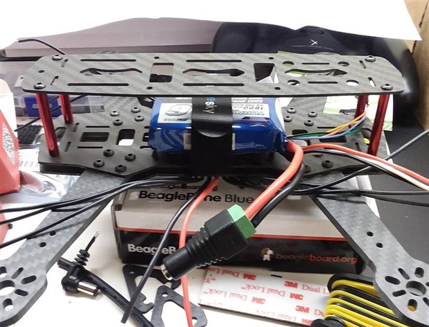

Hello Everyone,
I would like to use the BeagleBone Blue as the flight controller of my quadcopter drone and run ardupilotblue.
https://github.com/mirkix/ardupilotblue
The Brushless Motor Speed Control that I am using is the Racestar 20A 4in1 ESC mentioned in this parts list.
https://www.hackster.io/jkridner/beaglebone-blue-220mm-quadcopter-9801d8
I've been following guidance of these links and this tutorial but I've run into a few issues with construction.
     https://github.com/imfatant/test

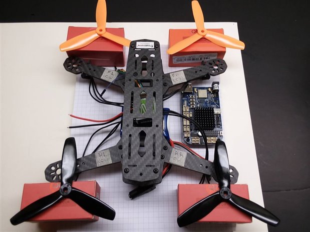

First question, Is this Propeller Layout correct in this photo?
The orange props are the front/nose of the drone and black props at the rear.
The orange props have leading edge facing inwards and with the black props the trailing edge is facing inwards to the body.
My terminology and setup might be completely incorrect. For safety reasons the first test will be performed without the propellers attached.

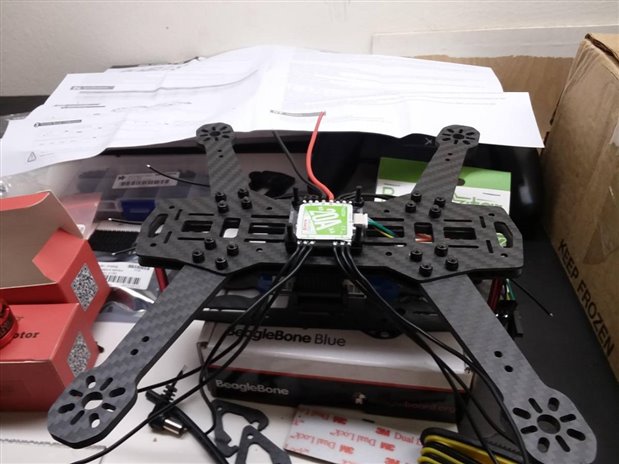

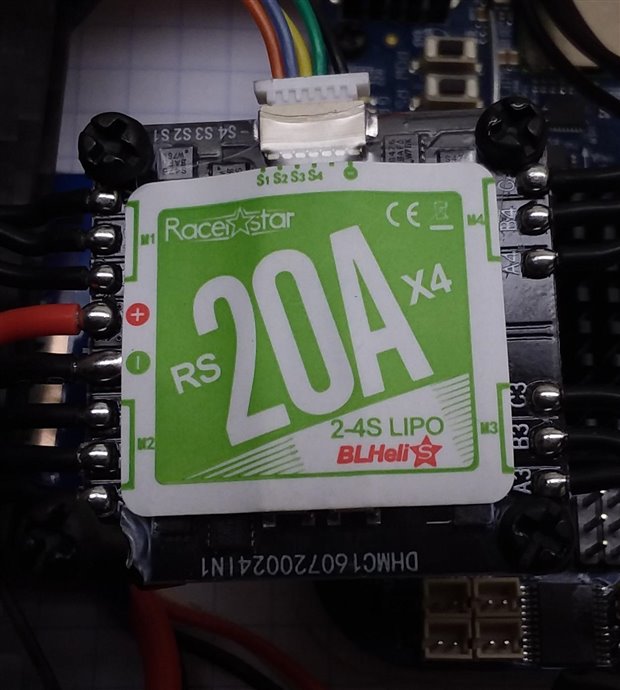

In which direction should the ESC be oriented on the the chassis?
And Is the label side of ESC board meant to face upwards with the plug facing front of the drone?
Also, Which pins from the esc should be connected to the BeagleBone Blue?
I would like to mount the ESC to the bottom of the drone as shown in the photo below.
I'm unsure if the ESC should be facing label side upward and which direction the control wiring plug should be facing in orientation to the front of the drone.
The Lipo Battery will be located in the center of frame.
There will be a small First Person View Camera and transmitter in the nose with 5V power supplied from the BB Blue.
The BeagleBone Blue will be secured to the top deck with the onboard IMU chip at dead center.
I am waiting for the FPV Cam/Transmitter and Ublox M8N GPS to arrive tomorrow.
When complete this BB Blue Drone will be running ArduPilotBlue and will be carrying a GoPro Hero 5 Session on flights.
Thanks for your time reading this post and for any help.
Trent

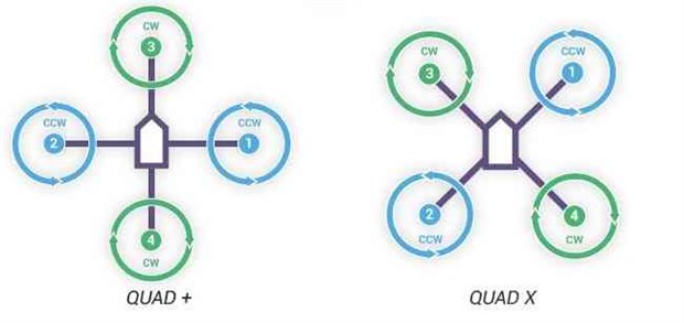

    The props look like they match the setup in the Quad X Diagram to me. They will be providing lift when rotating in the direction shown in that diagram. The orientation of the ESC shouldn't matter. The…

  • jomoenginer
    0 jomoenginer over 8 years ago in reply to ninjatrent
    The images seem to be fine now.
    As far as the ESC is concerned, you should be able to use the DSM2 header located in the bottom right of the BeagleBone Blue image you posted or E4.  This is described in the Receiver section of the ArduPilot github page you posted.
    Is the receiver you are using one of the the receivers listed under "Tested Receivers"?

    0 Fred27 over 8 years ago
    The orientation of the ESC shouldn't matter. The IMU on the other hand does need to be orientated correctly.

  • ninjatrent
    0 ninjatrent over 8 years ago in reply to Fred27
    The order of the motor wires on the esc are different from the order in the Quad X diagram above.
    Are the wires on ESC labeled "s1, s2, s3, s4" the signal wires for each motor and are these connected to the Servo signal wires on the BB Blue?
    If so, would I need to connect signal wires from esc in the same order as shown in the quad x diagram?

    0 shabaz over 8 years ago
    Hi Trent,
    Quite surprising how elsewhere on the Internet this project doesn't have a single overall solution diagram or wiring diagram, or a single photo showing such detail.
    It looks like the original source of those diagrams is here:
    Connect ESCs and Motors — Copter  documentation
    According to that, the number inside the green and blue circles are the "connected autopilot output pin" .
    The ESC will map the S1..4 signals to the M1..4 motors respectively, so for simplicity I suggest each circled number could be connected to the corresponding M number on the ESC. Then, label the connectors that will go to the BBB end with the same numbers 1..4, and test with them inserted in the order 1,2,3,4, since apparently the software has a test function which has buttons for Test A..D. The diagrams at the link above show what number motor should correspond to A..D, for the Quad + and Quad X etc formations. At that stage (i.e. with no propellers attached), you'll be able to swap the connectors at the BBB end until you've got the motors matching to what the software expects. Then, confirm the rotation directions are correct. If they are not, the motor wires need swapping (pick any two of the three wires to the motor, and swap them).
    So, all this should get the correct motors spinning in the correct directions - I hope! Please do document it when it works : )

    I think you have the solution here! There will be plenty of photos and documentation. I've taken notes, pics and created a wiring diagram for this ESC. It seems the ESC is meant to be label-side upwards. The motor orientation on this ESC is different than traditional 4 in 1 according to a review. The manual shows wiring for single esc which is not very helpful. The diagram provided by Ardupilot should be the correct layout.
    Do you know what the pinout is on brushless motors? On the esc the label for each motor is A,B,C. I can't be so simple as the motor pinouts match the ESC pinout.
    Trent
