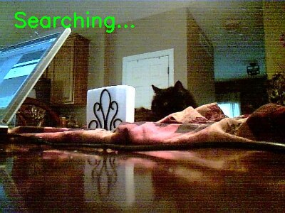

    I reverted back to 4.14 and got the classification.cpp to process again as you said.  It's much more responsive since they fixed the bug. It could use some training, but at least it processes fast and doesn't call my cat a ping pong ball anymore - although it did say coffee mug twice.
    At line 310, you can tap into the frame to do your own overlay.  Originally, it would put text on the frame if it just saw an object.  Below, I added an "else" so when it doesn't detect an object, the user gets validation that its at least trying:

    Back to trying to get a pin to input.  I'm getting the following error with input even though I've set permissons on the files it thinks are missing:
    ValueError: Set gpio mode failed, missing file or invalid permissions
    -Sean
