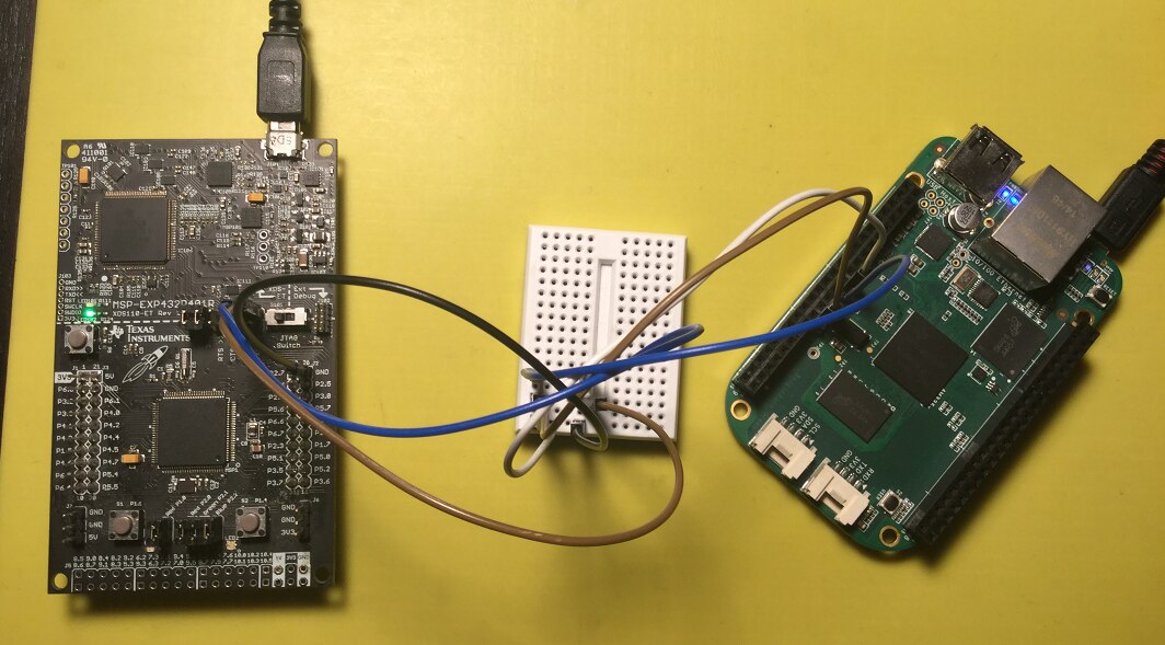

    Locate the debug header. I used this website as inspiration.
    Ultimate Serial Port
    You need:
    MSP432 LaunchPad , red or black) and BB
    2 USB cables, one for each. Don't plug in yet.
    3 female to female jumpers (I only have male to female and used a breadboard as interconnect.
    On your MSP432, remove the RXD and TXD jumpers in the middle. Don't worry about the other 4, they can be mounted or removed.
    Connect TX to TX, RX to RX. (yes, I thought I needed to swap but it is what it is - edit:because the PCB of the launchpad labels the microcontroller side signals). See schematic. Tap the signals from the debugger side of the LaunchPad
    Then connect the MSP432 USB. Check in the Device monitor what port number is assigned to the UART.

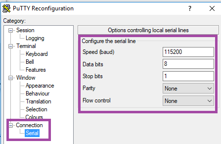

    Open Putty, create a serial connection.
    Here are the settings (use your com port)
    Connect.
    Nothing shows. That's normal
    Now plug in your BeagleBoard. Your putty session is an active UART session into the debug port.
