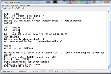

         I'm quite intereseted in Sabre-Lite running on Archlinux. I tried following the steps in the link that you posted. However, I am encountering an error whenever I tried to boot it up, it says "wrong image format for bootm command" and "error: can't get kernel image". I am quite sure that the tarball that I downloaded and extracted are the same.
         Did you encounter this problem? Can you also teach me how did you do it on your device?
         Please see the attached image for better understanding

    I'm not aware of having done anything special, I just created an ext3 fs on a micro-sd card and extracted the contents of the tar file onto it. As it says, you do really need to be root (and not using sudo) to do that as it contains /dev with device nodes which won't get re-created properly if you're not really root
    Other than that, I had the original factory version of uBoot installed, if you've upgraded yours then maybe that makes a difference ?
