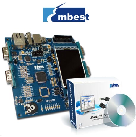

The Embest's LPC1768-SKLPC1768-SK is the low cost development kit for NXP LPC1768 (100MHz, the very fast Cortex-M3 processor), including the LPC1768FBD100,551LPC1768FBD100,551 evaluation board and Emlink for ARM JTAG adapter, so the developers can easy start to learn and test all the relevant applications on it, or evaluate your new project design through this entire system.
NXP LPC1768-SKLPC1768-SK Starter Kit contains all the necessary hardware and software and allows you to design, develop, integrate and test your applications:
  • NXP LPC1768FBD100,551LPC1768FBD100,551 ARMCortex-M3 Board
  • Keil MDK-ARM Development Kit, 32K evaluation edition
  • Emlink for ARM - a high speed JTAG Emulator for ARM Cortex-M3 processors
  • Plenty of example programs, all in source code (These software examples can be debugged under the popular Keil MDK (Microcontroller Development Kit) environments)

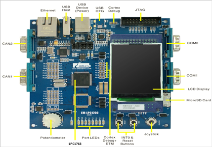

  • NXP LPC1768FBD100,551LPC1768FBD100,551 ARM Cortex-M3 Board:
    • Include one 2.4" TFT LCD (240*320)
    • NXP LPC1768FBD100,551LPC1768FBD100,551 processor, based on ARM Cortex-M3 Core, 100MHz
    • 512KB internal flash and 64KB SRAM
    • XTAL Frequency: 12 MHz
    • Two RS232 Interfaces
    • Two CAN Interfaces
    • One 10/100M Ethernet Interface
    • One ETM Interface
    • One Micro SD Card Interface
    • One USB Device Interface
    • One USB Host Interface
    • One USB OTG Interface
    • One 20pins JTAG Interface
    • One 10pins Cortex Debug Interface
    • One 18pins Cortex Debug Interface
    • One TFT LCD Interface
    • One Joystick with 4-direction control and selector
    • One Analog Output (connected to speaker by default)
    • One Analog Input (connected to potentiometer by default)
    • Supply Voltage: 5V DC (provided by the USB bus of a PC)
    • Supply Current: 65mA typical, 120mA maximum
    • Board Size: 119mm x 119mm (4.68" x 4.68")
