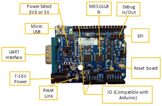

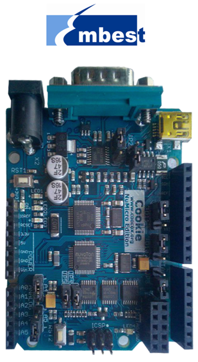

Cookie board is an open-source ArduinoTm form-factor compatible 32-bit ARM prototyping platform based on ARM Cortex-M microcontrollers. Offered along with a free ARM development environment from CooCox (Windows only), it helps you to enter into Embedded Development and makes it simple to add sensing and control to a huge range of projects, whether you are an engineer, designer, artist or hobbyist.
Cookie board expands the concepts of 8-bit ArduinoTm into 32-bit ARM Cortex MCUs. The Cookie NuMicro edition is based on the Nuvoton Cortex M0 microcontroller M0516LBN. The M0516LBN with Cortex-M0 core can run up to 50MHZ, with 64KB Flash for program memory; 4KB Flash for data memory, 4KB SRAM, 2 UARTs, 2 SPIs, and 1 I2C. The Cookie NuMicro edition is fully compatible with the ArduinoTm form-factor, with 14 digital input/output pins (of which 6 can be used as PWM outputs), 6 analog inputs, a power jack, an ICSP header; it contains everything needed to support the microcontroller. There is also an onboard CoLinkEx for debugging purposes.
Cookie board comes with CooCox development environment - a free & open ARM development tool environment (Windows Only). CooCox provides a complete tool kit including IDE, Flash programs, Graphical pin configuration, and code generation tool etc. The CooCox CoX Peripheral Interface, a unified peripheral interface, makes it easy to reuse Arduino-Shields across different Cookie boards based on different ARM Cortex M0/M3/M4 MCUs platforms.
As Cookie is an open-source platform, all the documents and sources are free for download. You can find the Schematic, BSP Code, and also the PCB file under the Technical Documents section below.
