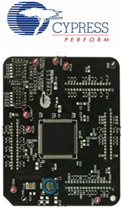

The CY8CKIT-010CY8CKIT-010 PSoCRegistered CY8C58LP Family Processor Module is designed to evaluate and experiment with Cypress's PSoC 5 programmable system-on-chip design methodology and architecture.
This processor module must be used in conjunction with the PSoC Development Kit (CY8CKIT-001CY8CKIT-001) to create designs utilizing on-board DVK resources or compatible expansion boards. This kit provides you with an additional processor module to use with different projects.
PSoCRegistered 5 is a true system-level solution providing microcontroller unit (MCU), memory, analog, and digital peripheral functions in a single chip. The CY8C55 family offers a modern method of signal acquisition, signal processing, and control with high accuracy, high bandwidth, and high flexibility. Analog capability spans the range from thermocouples (near DC voltages) to ultrasonic signals.
The CY8CKIT-001CY8CKIT-001 PSoCRegistered Development Kit provides a common development platform where you can prototype and evaluate different solutions using either the PSoC 1, PSoC 3, or PSoC 5 architectures.
Key Applications: Consumer, Industrial, and Medical applications
