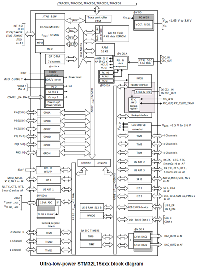

The IAR KickStart KitTm (STM32L152-SK/IARSTM32L152-SK/IAR) is a complete, cost-effective solution for starting application development and evaluating the STMicroelectronics STM32L EnergyLite ARM core-based microcontrollers. IAR KickStart Kit for STM32L contains all the necessary hardware and software and allows you to design, develop, integrate and test your applications, right out of the box.
The ultra-low-power STM32L15xxx incorporates the connectivity power of the universal serial bus (USB) with the high-performance ARM CortexTm-M3 32-bit RISC core operating at a 32 MHz frequency, a memory protection unit (MPU), high-speed embedded memories (Flash memory up to 128 Kbytes and RAM up to 16 Kbytes) and an extensive range of enhanced I/Os and peripherals connected to two APB buses. The STM32L15xxx devices contain standard and advanced communication interfaces: up to two I2Cs and SPIs, three USARTs and a USB. The STM32L15xxx devices offer up to 20 capacitive sensing channels to simply add touch sensing functionality to any application.
The integrated LCD controller has a built-in LCD voltage generator that allows you to drive up to 8 multiplexed LCDs with contrast independent of the supply voltage. The ultra-low-power STM32L15xxx operates from a 1.8 to 3.6 V power supply (down to 1.65 V at power down) with BOR and from a 1.65 to 3.6 V power supply without BOR option. It is available in the -40 to +85 °C temperature range, extended to 105°C in low power dissipation state. A comprehensive set of power-saving modes allows the design of low-power applications.

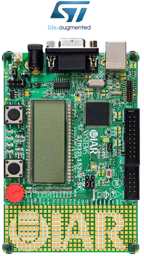

Kit Features
  • Full-featured KickStartTm development board with STM32L152VBSTM32L152VB MCU
  • Embedded J-Link in-circuit debugger/programmer with USB interface to host PC and 20-pin JTAG application interface
  • Small 19-pin trace tool connector
  • Graphic LCD display
  • USB connector
  • AN-TR wheel
  • Wake-up button
  • User button
  • Reset button
  • Power LED
  • User LEDs
  • 4 power options: J-Link (JTAG pin 19), trace connector (pin 11and 13), USB or external power supply
  • PWM routed to LED
  • USART routed to DB9 connector
  • UEXT connector
  • Prototyping area
  • RoHS Regulation (Directive 2002/95/EC) compliant
