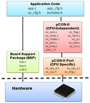

µC/OS-II, the Real-Time Kernel, is a portable, ROMable, scalable, preemptive, real-time deterministic multitasking kernel for microprocessors, microcontrollers and DSPs. Offering unprecedented ease-of-use, µC/OS-II is delivered with complete source code and in-depth documentation. Most of µC/OS-II is written in highly portable ANSI C, with target processor specific code written in assembly language. Assembly language is kept to a minimum to make µC/OS-II easy to be ported to other processors. To date, µC/OS-II has been ported to over 40 different processor architectures, ranging from 8- to 64-bit CPUs. µC/OS-II can manage up to 250 application tasks and provides the services including: semaphores; event flags; mutual-exclusion semaphores that eliminate unbounded priority inversions; message mailboxes and queues; task, time and timer management, and more.
μC/OS-II’s footprint can be scaled (between 5 Kbytes to 24 Kbytes) to only contain the features required for a specific application. Depending on the processor, μC/OS-II can be reduced to as little as 2K bytes of code space and 300 bytes of data space (excluding stacks). The execution time for most services provided by μC/OS-II is both constant and deterministic; execution times do not depend on the number of tasks running in the application.

imageOperating Systems and Stacksimageelement14 Knode
