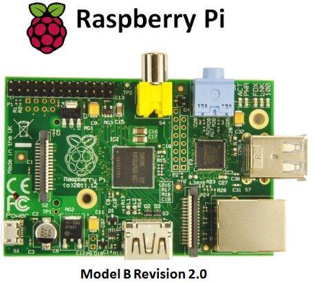

    PS the circuit board, for a wide area around both the USB and RJ45 connectors were painted with flux.
    This is a bad...Ive personally seen excess flux crash a 3,85 MHz clock in a VCR...and the signals on the Pi are a much higher frequency, on the order of 12 MHz on up, possibly to high UHF.
    http://alphacpmd.com/~/media/Files/CooksonElectronics/TP%20-RF%20Characterization%20of%20No%20Clean%20Solder%20Flux%20ResiduesWWE%20SM000%20CNP%2020100917.PDF
    There are hardware failures in the Pi due to faulty design. The below is written by a hardware engineer with massive RFI and circuit test./design experience, plus FCC cert and manufacturing.
    Those of you noticing USB problems, its not you, the Pis designers ignored the design requirements of SMSC for the LAN9512 IO chip, heres the long list, since there may be EEs floating through here.
    Management at Newark need to take notice, your Company and others are selling faulty product that is mis designed and is NOT USB COMPLIANT.
    Main problems:
    * false rumours of the need to use a powered USB hub - not relevant to failure of a wireless USB receiver drawing 28 mA
    * false rumours of power supply problems in the Pi (there arent, the supplies are clean and stable on an oscilloscope)
    * Numerous and serious design defects in both the circuits and CBA layout of the Pi - the Pis designers refused to adhere to SMSCs design requirements,
      especially inexcusable since SMSCs website offers design evaluation.

      Comparing the Pi schematic, the Pi board itself and the documentation by the component manufacturers
    we see many design mistakes in the Pi that are causing it to violate the USB design standards
    and not work with common wireless Keyboard and mouse sets.
      It is absolutely pointless to make and sell a piece of computer equipment that wont even work
    with a mouse and keyboard.
      There are so many serious electrical design mistakes on the Pi B board that it is pointless
    to even consider using it to develop code.

      Why is the connector location wrong?
      Code hacks and hardware designers know the USB power source is DC. They do not realize that the USB supply CURRENT is AC and VERY noisy.
      It is not acceptable to route the USB current past or through sensitive, high speed circuits as the noise from the USB current can corrupt signals.
      b.) See the SMSC document AN1920 (an1920.pdf)
        This documentation sets out REQUIREMENTS (not suggestions) of how the circuits must be designed. The Pis designers
      ignored them and now have a faulty product.
        1.) ibid, Sec. 4.3 requires the USB connector shield to ONLY be AC coupled, the shield on the Pi is soldered to DC ground.
        This allows USB device current to mix with USB signal currents and can cause data corruption.
        2.) Sect. 2.9.1 forbids using 90 degree turns on circuit traces, one USB trace on the Pi board has a 90 degree turn.
        Sharp corners radiate noise energy from very high frequency signals.
        3.) Sect 2.8.4 requires bias resistors be on the component side, R23,24 and others are not on the component side.
        4.) Sect. 2.5.1 requires crystal circuit components be on the top layer, they are on the bottm of the board.
        A corrupted clock signal could crash the entire IO system and maybe even the processor.
        5.) Sect. 4.2, requires DP/DM trace isolation, these traces are routed near R39 and C41, IN THE CRYSTAL OSCILLATOR CIRCUIT.
        This fault, by itself, can crash the whole board by the USB port signals corrupting the clock signal in the hub.
        6.) Sect 4.5.3, requires at least 150 uF capacitance for the USB connector, the Pi has a 47 uF, only half the required value.
        7.) Sect 2.2, requires one decoupling capacitor for each power pin, there is one missing on page 3 of the Pi schematic
        with the group of 7 power pins including pin 5- 7 pins, 6 capacitors is not "one for each pin."
        8.) Sect. 2.2.2 requires CALCULATION of individual decoupling capacitor values, this was not done on the Pi,
        the designers apparently assuming that all such caps are 0.001 uF; this is a common mistake made by designers and experimenters.
        9.) Sect 2.1 & 4.5.1 require sufficient power supply. If the Pi cannot supply power to operate USB devices, then its design
        violates both SMSCs requirements and the USB standard and is misleading to advertise to sell as USB -operable when it is not.
    4.) See Pi schematic P.3 and Document 9512.pdf. GPIO pins were left floating, this violates the first rule of digital design
    that "every pin must go somewhere". If these lines are left tri state or OD in software, they could couple noise into the package.
    5.) See Pi schematic P.3 and 9512.pdf Sect. 2.3. PU/PD pins must have external pull up.down resistors, the Pi schematic
    does not show an external resistor on pin 14. Apparently this entire circuit has been omitted as it didnt function properly.
    6.) The USB standard requires hot plug-able operation, hot plugging the KBD/mouse wireless receiver from MCM
    into the Pi crashes the entire board back to a hard reset. This is NOT due to power supply bounce, I have tested
    that with an oscillloscope. It is due to signal corruption.
    7.) False and misleading information on the Pi Forums on the web:
        a.) USB problems are blamed on lack of a powered hub. They are not, as proven by oscilliscope measurements
        and the fact the wireless KBD/mouse receiver draws 28 mA. Tests prove that even a USB extension cable improves
        operation without being powered,
        b.) claims that Poly fuses were use don the USB ports for over current protection are false, the Polyfuses
        according to Document 9512.pdf, Sect. 2.2.2 are for port power switching, not overcurrent protection.
      This Pi device is not suited for the intended purpose, especially as it is advertised /sold as USB compliant and
    is not, and there is nothing that can be done to remedy it without a complete redesign of the circuits and circuit
    board to comply with the USB specification and requirements of SMSC.
      As a result of the Pis designers negligence, thousands of these units have been sold to Consumers who are being
    deceived into thinking that the Pi works correctly and they must use a USB hub. This is a false premise.
