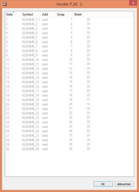

Hi @ all,
is it possible to make a "link" to a komponent on a other Schematik-sheet like "Port 12 is on sheet **sheetnumber**?
ich möchte auf einer Seite im Schaltplan einen Link / Hinweis zu einem Bauteil auf einer anderen Schaltplanseite erstellen : Z.B. "Klemme 12 befindet sich auf Seite **Seitennummer**" ... also keine Feste seitennummer, da sich diese noch ändern kann

    Ah.  I understand.  The short answer is that I know of no way to achieve
    this.  A workaround that has served me well in the past is to have all
    the pins for the connector on the same sheet, in fact, in close
    proximity on the same sheet.  Then the connections to each pin have a
    short net with a cross reference to another sheet.

    I have find out, i can make a list with the comand " invoke 'Plug' " ,
    but then i have a static sheet. When i move a Pin to a other place, then
    i have to create a new summary / compendium with invoke

    I know the command "lable xref" to find out the next place of a signal. But my idea wars to find Pins from a "multipin-plug" where are shared on different sheets.
    For example: You have a Plug with 10 Pins... Pin 1 on Sheet 3 , Pin 2 on Sheet 8, Pin 3 on Sheet 1956 ;-) and so on. In my dokumentation i want to have a Sheet with a list, where are thease Pins.
    You know what i mean? ... Lable for Pins, not for Signal-Lines
    I have find out, i can make a list with the comand " invoke 'Plug' " , but then i have a static sheet. When i move a Pin to a other place, then i have to create a new summary / compendium with invoke
