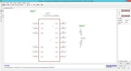

Hi all,
My first post here, so apologies if I have set my post out wrong, or posted in the wrong place!
I am having an issue naming my custom components properly, ie getting Eagle to name them IC1, IC2, etc.
I believe on the schematic, you must enter the symbol editor and then set the name of the component to >NAME. This appears correctly next to my schematic symbol.
Then when you are in the device editor, it replaces the name with G$1 - which from my understanding of the manual is a placeholder, or the default name - no worries there. I then set the prefix to be IC.
However the problem arises when I place the symbol in a schematic. The name appears as IC1G$1. The numbers do increment, but I would prefer not to have the G$1 after IC1.
After again reading the manual, it says that G$1 should appear in the device editor, but should be replaced by the IC1 completely in the schematic. Does anyone have an idea of what I am doing wrong?
I have connected all the pins to the footprint.
If you would like screenshots to understand my problems easier, by all means let me know and I can sort them out for you.
Many thanks for your time,
Sparky

    Hi,
    it seems your screenshot looks like multigate. A Gate for the
    inputs/outputs. A Gate for supply.
    Your workaround with >Part instead of >Name is a possible way.
    Patrick
    e14 Contributor over 13 years ago in reply to e14 Contributor
    I have managed to figure it out!
    Instead of typing in >NAME for each symbol, >PART provides just the IC number without the G$ part at the end.
    It provides the correct visual form I'm after, but if this is a fudge, I would still appreciate any help. image
    Many thanks again.
    Michael
    e14 Contributor over 13 years ago in reply to autodeskguest
    Many thanks for the reply Jorge.
    I have made sure the step is "next", and although it is not multi-gated, I have seperated the supply pins to alow me to produce cleaner schematics ( I don't want these to be hidden, however). Perhaps that is where the problem is? I have attached a screenshot below.
    Sparkyimage

    Hi Sparky,
    Check the addlevel of the part and make sure that it's set to Next and
    not something else. Is this a multi-gated component? If it is, then for
    the extra gates you would change the gate name to A,B,C, etc. or some
    other naming convention.
    We'll go from there.
