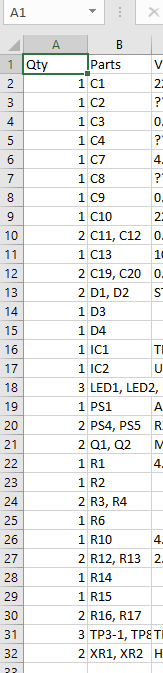

Hello,
I'm using bom-ex.ulp to generate a BOM for my schematic I created.  When I select the radio button 'Values' under 'View By', the display is exactly what I want the file to be saved as.  However, when I click the Preview button, or the Save BOM button, the sort order changes on me.  I would like to save the BOM as displayed; sorted by Parts.  It seems to re-sort the list by Values.
I've been digging around the ULP code in bom-ex.ulp but I can't seem to make it do what I want.  I really just want the file I save to be sorted by Parts and not Values.  I've attached some screenshots showing my problem.  The first image shows how I want it, and the second image shows what happens when I click Preview.
Is there anyway to save the BOM so it comes out sorted by Parts and not Values?

    Hi Matt,
    Not sure if you've already sorted this out yet. Thanks for opening the thread, glad other people had the same issue. I feel a little less silly spending some time figuring this out but I think I found a fix!
    Edit: looks like my fix below messes up the part grouping. The sort by values is needed for they way the example bom.ulp finds identical parts to group onto the same line.
    However, looks like this place has solved the issue by redoing the way the ulp finds identical parts AND sorts them by designator!
    http://www.pcserviceselectronics.co.uk/eagleulp/
    1. Digging into the BOM.ULP, there's a sort( ) function line that needs to be modified so it sorts on PartName first instead of PartValue
    here's a snippet from my customized BOM_custom.ulp

    Comparing commented out line 12 with line 13: I moved PartName just after Index. If you read the documentation on sort( ), NumParts is just an integer, Index is an empty array, and the first array after Index is the first one to be sorted. However, the sort( ) documentation is pretty thin and doesn't describe the behavior of how you order the arrays within the function call.
    The sort( ) function was a little hard to decipher but some trial and error this looks like it works!
    Essentially the internal list generated by the ULP isn't affected at all by the dialog box, the ULP just prints to the dialog box but the internal list is separate, and when you hit Save it just takes the internal list "Lines[ ]" and dumps it into the csv.
