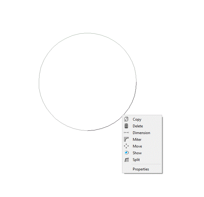

    So i seem to be battling. I have imported the DXF for the CAD drawing which gives me my layout of where i want LEDs etc. It appears my holes are drawn as 4 x 1/4 round segments so selecting only selects one quadrant and not a full circle. How do i join the quadrants into circles. I saved the ULP but it doesn't work even if i select all 4 quadrants of the circle/hole.
    I have been battling for hours. First time i am trying something like this BUT it is much easier to design the PC board around the panel

    Many thanks for all your assistance. Si i have a new ULP now ArcToHole
    I run it and get:
    Run: ArcToHole.ULP: Finished. I right click a segment but i get no option to create a hole:

  • rachaelp
    0 rachaelp over 10 years ago in reply to rachaelp
    Hi Sean,
    The below should help. save it as arcToHole.ulp and then issue:
    run arcToHole install <return>
    This will add the insert hole options to the WIRE context menu. I'll only add holes to arcs but just be aware that is where it is. So DO NOT GROUP all the arcs in your circle when you run this or you will end up with multiple holes in the same location.
    I tried changing it along the lines of Lorenz's suggestion earlier to avoid needing to mess with the grid but it wasn't doing as I expected so have kept my original method for now. If I get the simpler way working I will update.

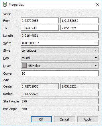

    0 shearder over 10 years ago in reply to autodeskguest
    Hey there here is the info. I copied and saved the ULP and even when i selected all arcs/quadrants and ran the ULP it did nothing - it does indicate that the ULP did run and says "Finished" but nothing to be seen.
    I have also attached the SCR which will create the PC board i am lookng for. the 5mm circles are LED placements all other holes are to be cut out and the rectangle is also a cutout. The outside rectangle should move to dimension and is the boarder of the PCB. I will machine this with my CNC from DS 300mmx300mm PCB

    Hi again,
    what info shows the "info of your quadrant?
    Is it an arc?
    If so than we(or racelp thanks for the ulp image) can think about
    it (b.arc).
    The issue: if the ulp goes straight throu all "arc" we get 4 holes per
    dxf Hole.
    HTH

       exit(cmd);
    Best Regards,
    Rachael
  • shearder
    0 shearder over 10 years ago in reply to rachaelp
    That will be awesome. Thanks SO much. I tried to attach the SCR file but not allowed. I tried a couple of CAD packages and in Rhino if i join the arcs i get smaller segments in Eagle.
    Here is the DXF attached.
    https://community.element14.com/cfs-file/__key/communityserver-discussions-components-files/308/Panel.dxf
  • rachaelp
    0 rachaelp over 10 years ago in reply to shearder
    Hi Sean,
    It currently won't work for arcs, it only works for circles. I'll update it and see if I can make it work for you.
    Best Regards,
    Rachael
