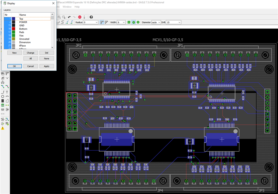

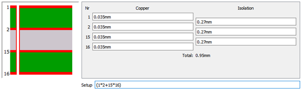

Hi, I'm trying to create a 4 layer PCB (TOP + POWER + GND + BOTTOM). I created 2 planes for the VBB and GNDBB using polygons.
My problem is the connection (let's say) beetween a resistor and the PAD of a component (let's call it X component). If try to connect the VBB connection of the resistor to a Via (and the via's name is VBB) the VBB PAD of the X component with appear like the pic below and the airwire that was connecting the resistor to the X component is gone!
But if I try to do the same with a resistor that is connected to a GND pad, the pad stays the same and the airwire is still there, which makes me wonder if the vias are even connecting to the GND plan.
The following are printscreens of the settings I'm currently using.
What am I doing wrong here?
Any help would be highly appreciated!
    Note----
    Note----
    If your ground plane polygon is named "GNDBB" it will not connect to
    vias named "GND". They need to be the same.

    On 31.05.2016 14:15, Morten Leikvoll wrote:
    On 31.05.2016 13:47, Nuno Gomes wrote:
    The pin10 of the JP2 is indeed the GND. This is what the device looks
    like:
    Yes, the hatched grey layer is layer 15 and the polygon is named GNDBB
    because there are two tipes of GND plan and two power plans (GND +
    VDD3.3 & GNDBB + VBB) the GNDBB + VBB are two polygons on top of each
    other and are the ones closer to the border of the PCB.
    In the last pic of the original question there are indeed two layers
    on top of each other, not sure if that's the problem.
    I'm not sure about what you "said " Pin1 of JP2 looks connected to
    GND" because the pin 1 is the POWER (square pad) and it's connected to
    VBB.
    Pin1 of JP1 just looks funny. Or maybe its the blue wire that goes from
    there to the capacitor. I would expect to get this signal from a via
    down to the polygon instead of routing all the way to the pin.
    Did you check what name the airwire got? Maybe its not connected to what
    you expect. Have a look at the schematic and try moving JP2 around to
    check if its pins are connected to what it looks like.
    An alternative way is to click the show button, then the airwire. Both
    the airwire and the polygon should highlite. If not, they are not the
    same net.

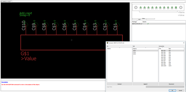

    The pin10 of the JP2 is indeed the GND. This is what the device looks like:
    Yes, the hatched grey layer is layer 15 and the polygon is named GNDBB because there are two tipes of GND plan and two power plans (GND + VDD3.3 & GNDBB + VBB) the GNDBB + VBB are two polygons on top of each other and are the ones closer to the border of the PCB.
    In the last pic of the original question there are indeed two layers on top of each other, not sure if that's the problem.
    I'm not sure about what you "said " Pin1 of JP2 looks connected to GND" because the pin 1 is the POWER (square pad) and it's connected to VBB.

    Also, I think you need to do better routing on this. My initial reaction
    is that this needs some proper engineering. Like proper decoupling,
    proper heatsinking and proper widths for higher currents here and there.
    Those lower chips looks like power hungry chips.

    I'm not sure I understand the question.
    Just make sure the through hole GND pad is surrounded by a polygon named
    GND. A SMD resistor pad needs a via closeby to get to inner layer.
    And remember to do ratsnest.
