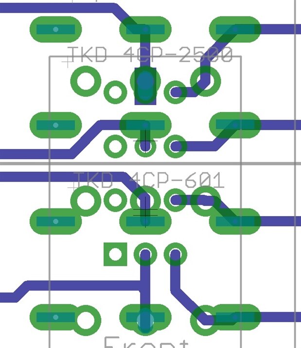

Hi,
I did a brief search thru the forum but didn't see this asked already.
I am laying out a 2-sided board, and wanted to put 2 different connector footprints/pads/holes to allow the user to select which connector type to use. These are 3-pin Molex KK 0.100" and Phoenix 0.508" connectors. The center pin of each is connected to a top ground plane. In the past on commercial PCBs, I have manually added the Molex connectors in exactly this way, and they fit fine. There is also ample clearance between the pads for pins 1 and 3 of both connectors (no DRC errors).
If I superimpose the connectors on one another (same x-y location), the ground plane will not fill in the connection to either of these pads (2 airwires). If I move the connectors apart it works fine.
Any tips?
Also, I assume this might give DRC errors for drill distance? Can I just ignore those?
Thanks, and great forum!
Chris

    Based on the feedback from Warren, I redid some things.
    1. Combo Molex/Phoenix connector part, so no double drilling with different bit sizes on the center pin.
    2. For the last point, I added rounded slots in the milling layer, as well as a rectangular copper pad on both top and bottom for the center pin overlap. Since the slot should be cut first, the drill problems shouldn't matter, but I am not as experienced with fabs as most of you are. Here is a pic of the board without the top layer. The fab that is going to run these does do plated slots, with a minimum dimension of 0.8mm. The rectangular slots for the 12 pins on the CP2500 are 3.2 x 0.8mm. The blades on these are either 3.0 x 0.4mm (older production) or 2.5 x 0.4mm (new production).

    I found the problem... I had drawn the polygons for the ground planes with 0.8128 width. Decreasing this to 0.4064 metric filled the pins in correctly.

    Hi
    You have a number of issues with your board
    (1) in your schematic
    Use the show command on the nets to the centre pin of J3 and X7. You
    will see the net is not connected and has a different name.
    J3-2 = N$1
    X7-2 = GNDL
    So rename N$1 to GNDL
    (2) Some of your thermal problem comes from the polygon wire width if
    you reduce the width to 24mil the results are better but not elegant.
    (3) You should use the same drill hole for the middle hole of the two
    connector styles.  The way you have it there will be two holes drilled,
    very close to one another and won't pass the board house clearance
    rules. You could move one element so that the centre hole aligns with
    the other but that would spoil the screen printing.
    I suggest you create a new package with the 5 pads and new tPlace
    outline in each place you have a connector choice.
    You can still have a schematic symbol with three pins. When you create
    the device, connect the pins 1 2 & 3 to pads 1 3 & 5 and append pad 2 to
    pin 1 and append pad 4 to pin 3.  Your connector position will have only
    one name on the schematic and board instead of two as you have it now.
    (4) The rear centre pin of P1 has the same drill problem of being to
    close to another drill. More thought is required here. If you are
    plating the milling then you could make a mill plunge to create the
    large hole. Board house tooling rules need to be investigated
    HTH
    Warren
