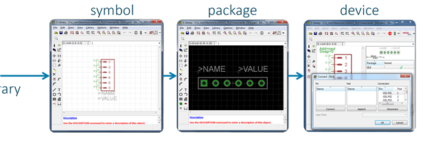

    0 shabaz over 10 years ago in reply to konsolkongen
    Hi Martin,
    The center of the green circle signifies where the signal connection will be made to other components, so faces away from the part.
    It is often an assumption that the package correctly matches the part so for this reason I always create my own symbols, packages and devices for anything more complicated than a resistor/capacitor. I'm not saying it won't work out for you if you use it, but it may be good to check the positions of some of the pins to confirm they are in the positions you expect, same pitch, etc.
  • konsolkongen
    0 konsolkongen over 10 years ago in reply to shabaz
    Thanks again. I was just messing around with that, without much clue what I needed to do.
    I have made a shape and all the pins in the symbol editor now. For the pins, is the green circle (like in your picture) supposed connect to, or face away from the part. Or does it not matter?
    I seem to have the drawing of the socket (the package) correctly copied from the other library, so I guess that will save a lot of time, as it should already have all the correct dimensions for the board view, right?
    I haven't been able to figure out how to connect the symbol and package yet, but it's getting late, so unfortunately it will have to wait for another day.
    Sigh... this was supposed to be just a few hours work and done. It's literally just the socket and some solder pads, nothing else... image
    Hi Martin,
    You'll need to create a symbol too, and then marry them together in a device.
    This is described better in the EAGLE PDF user guide (and various user youtube videos), but the diagram below shows approximately where you need to get to.
    Once this is done, you can add the device in a schematic, and then generate your PCB from that.
