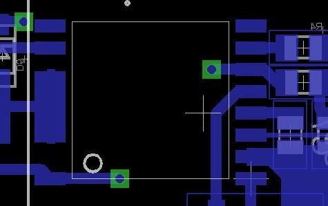

Hi,
I am designing a power supply PCB I have a polygon covering the PAD of one of the ICs There are several small PADS and a big PAD. Now when polygon on the top of the small pads and have the thermals off I see that the polygon fills only the small PADS completely but there is a problem with the large PAD.
How do I resolve this.
Here is the picture for the same
Thanks and regards.
Siddharth

    tPlace is probably the layer you intended, yes. It's used for the
    silkscreen. There's also tDocu for additional outline segments that you
    don't want on the silkscreen (e.g. because they overlap pads)

    Thank you, My bad, I designed the component thinking about the dimension of the particular component, Should I change it to tPlace?
    Siddharth

    I have one more thing to add.
    When I have that perticulaer component on the TOP SIDE why is that it is effecting the PCB on the BOTTOM
    You answered that in you previous post. The problem you have is with
    objects in the DIMENSION layer. This layer represents edges of the
    board, which clearly affects ALL layers.
    Why have you got anything in the dimension layer in your component?

    Hi,
    Thanks for the response.
    I got the reason behind those polygons not filling the complete area near the PADS. the reason being the "Dimensions". Due to that dimensions lines It is only allowing the trace not the polygons to fill. How do I overcome from this?

    Look at the Isolate setting on the polygon. I have had it set so high that it wont even make a connection to a pin.
    I would also check the layout of the pad itself. There is a check box for thermals there too.
