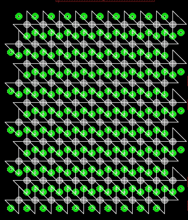

I have a .brd file with 100 pairs of through-hole vias (see the green vias in attached image). Each pair is supposed to be used as power and ground for micro-devices.
The via's outer diameter is .5 mm and the actual via hole is .15 mm. Since it is quite difficult to solder to such small vias to wires, I was thinking about routing traces from vias to pads for pin headers at the edge of the board.
The problem is since this is a .brd file (no schematic) and there is no other components except vias I cannot use the autoroute function. Is there a way to auto-route the traces from vias to pads for external header connectors?

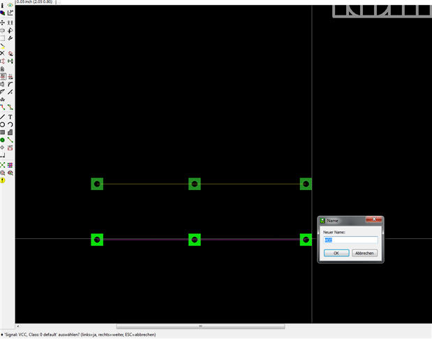

    Eagle must know the signal name of connected vias.
    Name them, after there are unrouted "ribbons" between equal named vias (Layer 19).

    0 autodeskguest over 8 years ago in reply to elliiot14
    So give them one and you see the connection as ribbon on layer 19 tha can be routed.
    To view any images and attachments in this post, visit:
    https://www.element14.com/community/message/233082
    When there is only the board, the above does not achieve the
    airwires/nets/signals. Rememeber there is no schematic and hence there
    are no known nets or connections.
    When creating the SIGNAL it cannot be connected to the via but if the
    signal is created first and then you name the via, it will pick up an
    airwire.
    The problem is, the OP talks of a header where one pad of which connects
    to the via. To get the signal in the first place, the header pad needs
    to connect to another pad or SMD. It cannot be established to a named
    via. Once you have a signal between two pads, you can view the name of
    the signal on the header pad and then name the respective via and an
    airwire will appear. Then you can delete the unwanted airwire and the
    other package that was used to get a pad temporarily for the first step.
    HTH
    Warren
