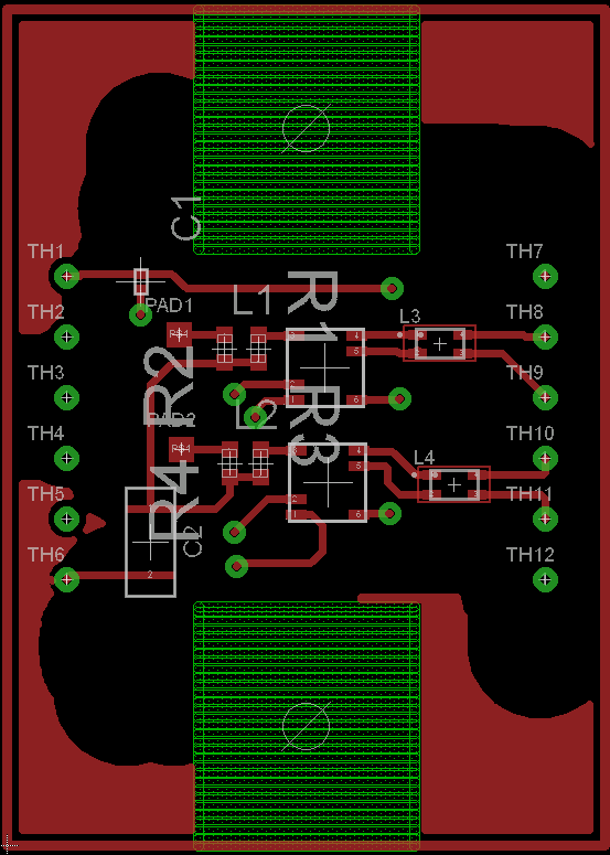

I am currently working on a board right now and I cannot make a GND plane. What am I supposed to do with the gnd terminals of the components of the board
Also, when I try to create a polygon and naming it GND it would still not create a gnd plane because when I click ratsnest it says there are airwires not connected so I connect the airwires using route then after I connected the GND terminals the ratsnest says there is nothing to do. Please help me!

    one more thing, that gnd plane appeared only when I checked orphan in polygon properties but if I do not check the orphan the plane won't appear.

    On 24.04.2018 08:52, Hennessey Balbin wrote:
    Thank you for helping but when I do it the resulting ground plane looks like this. see attached photo pls
    Wow this looks weird. I suspect you have stuff at the hidden dimension
    layer? You can see the fill trying to keep an extreme distance to some
    features. If you try to find the center of those circular shapes, you
    should be able to track it down. Show all layers, and you will most
    likely see it.

    Thank you for helping but when I do it the resulting ground plane looks like this. see attached photo plsimage

    Hi
    "Airwires not connected" should not happen. In theory they have to be
    connected to a contact at both ends. But over the years people have
    found they have scraps of unrouted airwires remaining from
    mis-operations they have made.
    Question: are you building a board only and did not create the board
    from a schematic? i.e. there is no schematic.

    Route the GNDs together, don't let ratsnest do it. (After that you can
    use ratsnest)
    Name your polygon the same name GND.
    In case of multilayer board your GND polygon must be on the same layer
    with the other GND connections. Provide a via if necessary.
    Possibly use command:SET POLYGON_RATSNEST ON
    (or OFF) the same way as written in capital letters.
    (I have both commands on keys in the board layout.)
