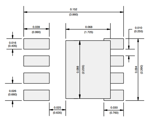

    With the manual addition of cream and stop masks, should I expect an exposed irregular pad in my final PCB after manufacturing?  I want to make the footprint of an inductor (below i include image) so I need this area to be exposed. (I dont know if i just should make a giant rectangular pad, even though the image shows a different footprint).
    I have drawn the shape in top, stop mask and cream mask layers. However, when i try to connect the component, the only connection possible is to the smd pad inside the polygon. That is the reason because i fear ending with a rectangular smd exposed inside a big cooper plane.
    What should I expect?

    0 autodeskguest over 10 years ago in reply to e14 Contributor
    On 12/7/2015 4:40 PM, Marco Casillas wrote:
    Hi!
    Yes, the stop masks is what makes the copper exposed.
       I want to
    The SMD pad defines the electrical connectivity so the traces will want
    to route to the SMD pad within your irregular shaped pad. Don't worry
    though, the manual additions of stop and cream will make sure the whole
    pad is exposed.
    Let me know if there's anything else I can do for you.
