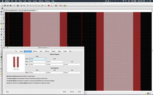

Hi,
I tried to verify the routing, but it fails stating the clearance rules are not followed. I tried to change the clearance from 0.2mm to 0.1mm, but that didn't help.
it was even complaining about the space between stm32's pads. here are couple screenshots.
what am I doing wrong?
thansk, Alex

    Check your net classes. The clearances specified there have to be
    satisfied as well.

    oh, silly me.. thanks a lot!
