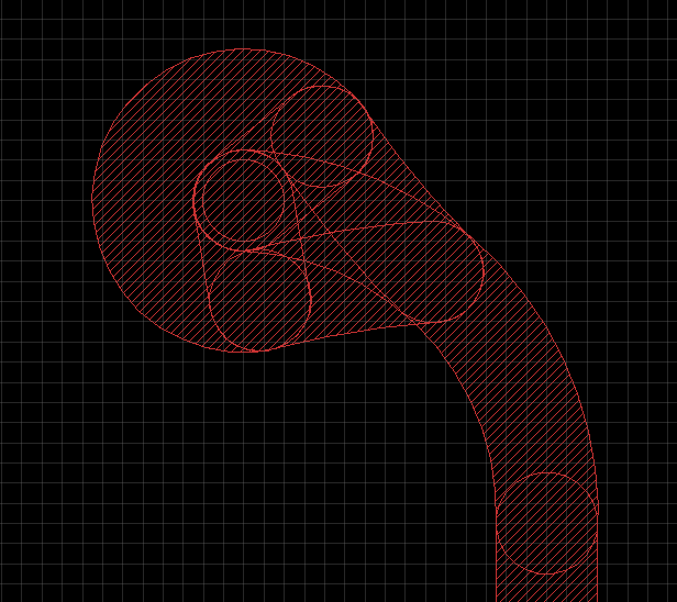

    0 e14 Contributor over 11 years ago in reply to autodeskguest
    Warren,
    Thanks for the potential workarounds; I understand what you are describing.  My knowledge of ULP and the data structures, however, is non-existent.
    It appears that the product is not quite ready to do the serious work I was hoping to occasionally do.
    You gave me an idea….. What might be an even better workaround might be: for the person that does the teardropsc URL (helpful in preventing breakout with drill wander and providing a more secure connection to vias), to also include an arc (of the same signal) that mostly surrounds the hole, with each end of the arc at the teardrop intersections with the capture pad.  After teardropsc is run as one of the last steps before generating Gerbers, the inner restring value can then be minimized.  The snippet below shows what might result in an inner layer – being just my curved trace, two short traces, and three arcs, to cover the area that needs to be occupied by the normal restring capture pad.  The via hole is the circle in the center.image
