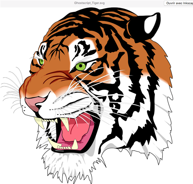

Hi all
I can't import a SVG file on EAGLE 7.4 with OS X I have this error message
"You must at least 3 point to create a polygon !!!!"
Any idea ?
Help should be great.
Thanks
Ritchie

    How are you importing an SVG into EAGLE? I've looked and I have no import option for this and there are no ULP in my installation in any v7 version of EAGLE that look like they would do the job. Is this a 3rd party ULP you are using? From the error message it looks like maybe something that is just a line with a start and an end point in the SVG is being interpreted as a polygon by the imported and hence it doesn't actually have enough points to draw the polygon. Where does the SVG come from? Is it exported from a drawing tool or something?

    Hi Rachael and many thanks for your prompt reply.
    The ULP for SGV import is "svg2poly.ulpt" here the link enclosed :
    https://github.com/cmonr/Eagle-ULPs
    I tested this ULP because I have more prob. with OSH Park, when I upload my
    project with a logo in bmp it seems to be not recognize !!!!!! I decided to
    test with alternative SVG import but not working....I'm going to be crazy
    Do you can do some tests for me please ? try to import the logo I attached
    and upload the berber fiel into a zip on OSH Park and let me know ?

    Yes that's the picture and it works fine for me, although it must be noted once converted to DXF it's just a line drawing not a full colour tiger. It also takes an age to draw. When you import the DXF does it take a long time importing? What does the script in the run script window look like?

    I've not seen your actual SVG file but I can't think why it wouldn't work with the process I have described based on my tests with arbitrarily complicated SVG files. If I can import an awesome tiger as a line drawing into a test board I am sure your logo will import ok as it's likely to be way less complicated than that.

    So you've not taken your SVG file and converted it to DXF using the web converter I linked to?
    The import process in your video seems to take a very long time and if you look at the script it generates there is nothing of note in it which explains why it draws nothing. I think the DXF output from Adobe illustrator must be generating something that the importer in EAGLE doesn't like.
    So I searched google for SVG files of varying complexity to test this out, I found a simple one of some gears first, then some more intricate patterns and finally I found an SVG called "Awesome Tiger" all of which I exported to DXF using the website I linked and then imported into EAGLE. They all worked. The last one took a LONG time to draw but I now have a test board with a line drawing of an awesome tiger!
    It seems that the process I described above, using the tools I suggested, does actually work. I think if you take your SVG file and convert it to DXF in the same way I did then you might find it works.

    However, I notice you've used Ghostscript to convert your SVG file to DXF? That is NOT what I did. Use the online converter I linked and it will work.
