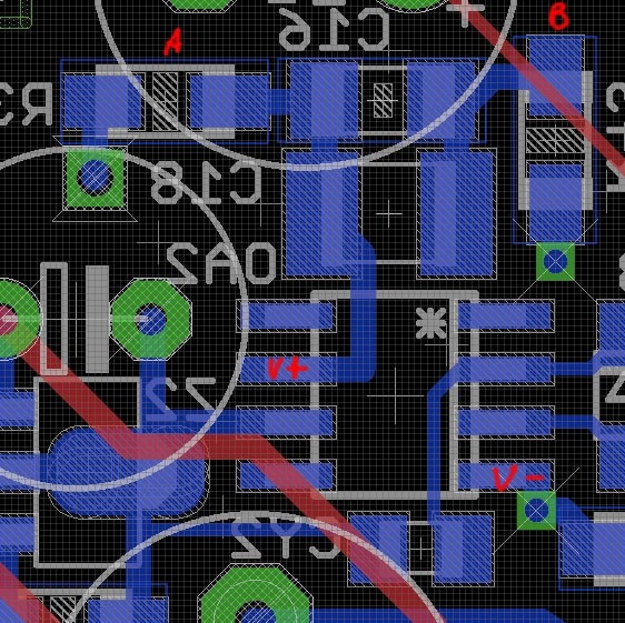

I'm not sure I'm going to explain this very well but here goes....
I have a board in which I have bypass caps filtering the supply to an op amp.  The "V-" of the op amp supply is GND and GND is a plane on an internal layer. However rather than just using a via to connect the low side of the bypass caps to the GND plane I'd like to force a routing to the via which connects the op amp V- pin to the GND plane. This would be straightforward except I need another via to make the routing on the top rather than bottom layer (where the op amp is sitting) and as soon as I place the via to get to the top layer it connects to the GND plane. How can I isolate this via from GND?
Thanks in advance
Steve
Btw I can only use vias that go through the entire board

    FWIW this is the worse of the two situations. With caps reoriented
    Resistor B is there to boost the ESR of the two decoupling caps if need be as the circuit is a regulator where the op amp is supplied from Vout and hence the decoupling caps influence stability.

    Thanks.  It seems I more or less have it "correct" at the moment but I was advised to 'connect the caps directly across the supply pins' which made me think I had it wrong.
    I did want to answer your question.  I can connect to the via to V- just fine.   I have the IC and decoupling caps on the same layer.  (Perhaps distances would be shorter if the decoupling caps were on the top layer directly above the op amp but space is limited.)  I have two instances of this on the board.  For one, the situation is easy as the decoupling caps can be oriented so their low side is very close to the V- via - I can connect both at the same via to GND.  For the other, I've found myself with the decoupling caps on the opposite side of the IC as the V- pin and routing on the same layer isn't possible.  Hence the contortion - if not a via to GND plane - of having to route from bottom to top layer with a via and then route across to the V- via to GND.  It's the first via (rather than the V- via) which posed the problem in Eagle.
    I will examine placement again and stick to using vias to the GND plane.
    Thanks
    rachaelp wrote:
    So doesn't your via which connects to V- therefore go through the board so you can connect directly to it?
    If you have a GND plane the lowest inductance solution for the decoupling capacitor is to place it as physically close to the V+ pin with a via right next to it to your V+ power plane and connect a via immediately at the other end of the cap to GND and then connect your V- to the GND plane with a via as close as possible to the V- pin. The placement and orientation of the cap should be such that it minimizes the overall distance. Your solution will increase the inductance in the loop a) because you are using a trace rather than the plane and b) because you are adding in an extra via, and the net result will be to reduce the effectiveness of the decoupling capacitor.

    rachaelp over 10 years ago in reply to stevekale
