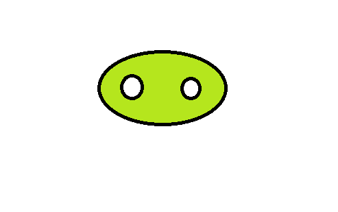

Hey Guys,
maybe someone could give me some advice how to create a pad with two drills.
So my question is how i can create a package of a pad with two drills as illustrated in the picture below.
I thought about takeing a polygon with the right shape and placing two drills inside. As well creating a CREAM shape around it.
Maybe someone could give me some advice.
Greetings!

  • autodeskguest
    autodeskguest over 8 years ago
    You are onto the right path. You may want to apply both a cream and a
    stop polygon. Stop to expose the copper, cream for the paste mask if
    manufactured by a factory. Think how you want it to look at the other
    side of the pcb as well. You may want to apply cream and paste there as
    well.
    I would use a VIA (if you draw on board) or a PAD (if you draw in the
    library). You may want to disable stop/cream for these VIA's or PAD's
    but it is probably not needed.
    If you draw PAD's in a library, you can connect the PADs from the
    connect function in the device editor, so they become one pin. If you
    draw VIAs on a board, you just name them (via's and polygon) the same
    name to merge as one signal.

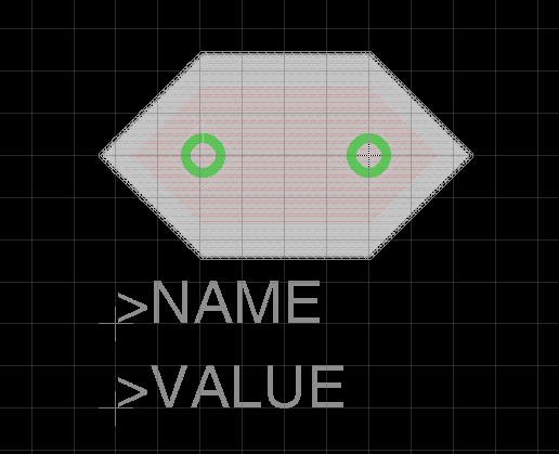

    I created a polygon in the package lib and placed two pads inside. As well I did add the cream and stopp shapes on the top and bottom side!

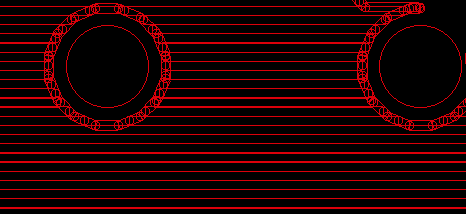

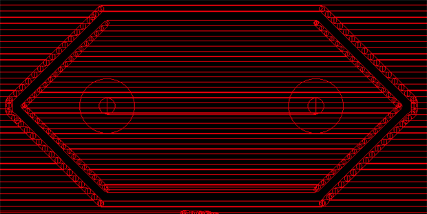

    Maybe I just have a misunderstanding of the GERBER Data. I'm worried if it is normal that i cannot see the drills on the top side?
    Picture of the package:
    Further more the picture of the Gerber Data:
    TOP SITE
    BOTTOM SITE
    Thanks guys for your help image
  • autodeskguest
    autodeskguest over 8 years ago in reply to horizon696
    The result looks fine. The gerbers will not fill copper over plated
    holes like pads or vias. The bottom side (if used) will end up with a
    rest-ring. It looks to me that you have set the restring very small and
    this will upset the pcb manufacturer. Check your DRC settings for this
    parameter. It may also grow outside your polygon edge on the top layer
    if set too large.

  • horizon696
    horizon696 over 8 years ago in reply to horizon696
    Jeah i know the DRC will cry! hehe image i just wanted to see the gerber Data image. Thanks again for the fast answere!
