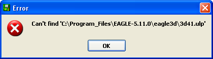

Hello friends
I need your help for the create script for the EAGLE
I use this command (Bill Of Material : RUN BOM-AM-17.ulp; | \) from scripr to run a ULP file and it works properly
The problem is that I want to execute ULP that is found in my own folder in located in C: \ Program Files \ EAGLE-5.11.0 \ eagle3d \
How to write the RUN command to include the path that I
Please help me thanks

    I tried the command (RUN "C:\Program Files\EAGLE-5.11.0\eagle3d\3d41.ulp"  but it turns out error
    He has a problem with Program Files folder It cannot occupy him
    I tried the command (run C:\Program_Files\EAGLE-5.11.0\eagle3d\3d41.ulp)
    again gave an error message for non-existent file
    but the file exists, I can not understand why

    the problem here is that the path contains a space  character between Program and Files. So you have to start the ULP with  the RUN command and put the whole path into single quotes (I used double  quotes in my first post, sorry...).
    RUN 'C:\Program Files\EAGLE-5.11.0\eagle3d\test.ulp' ;
    There  could be also a second problem. I don't know the ULP you are working  with, but i could also be the case that you have to verify the ULP   itself. If there are some statements that are referring to files the   paths there have to be set into single quotes as well. So please check   the ULP for this.
