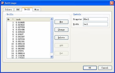

2. The image shown below is the Drill tag of Setting window that popped up when running SET command. Please help to explain the function of “Add” and “Set” buttons in the window, and when do they become usable? And what is the “Drills” list used for?

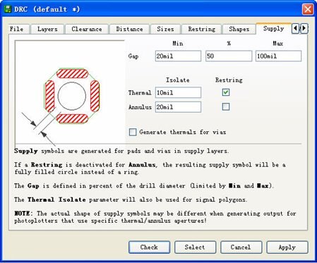

4. The figure shown below is the Shapes tag of DRC window; I am not clear about the Restring check-box after the Thermal and Annulus text-box, what’s the different if they are checked?
    This list assigns drill symbols with a certain drill diameter. In the manual you find a table of drill symbols. Symbol No. 1 looks like a plus sign, for example. Here you define your own table that fits to the drill diameters in the board. If you use the Set option, EAGLE list all used drills (maximum 18 different values) and assigns them to the drill symbols automatically. The drill symbols are drawn in the layers 44 and 45. You can see them
    when displaying these layers. The purpose is for printing a drill plan which can help in drilling boards manually.
    By the way: It has nothing to do with the drill table EAGLE creates when generating drilling data with the CAM Processor.
    The restring setting for an annulus symbol changes the appearance of the symbol. If restring is active, there is an isolation ring around the drilling. If you set it off, the isolation symbol will be a filled circle. the whole area around the drilling is copper free. Restring for Thermals behaves similar. If you deactivate Restring there, the isolation area will be created directly at the border of the drilling. This will result in a smaller diameter of the thermal symbols in supply layers.
