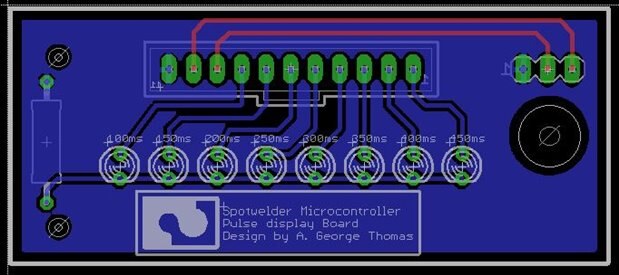

Hi all,
Since i've started using Eagle, i am now very much familiar with designing one sided. I thought i'd try out double sided.
My idea is to design a PCB with a 11pin connector on one side, 8 led on the other and a POT. So that the connector do not come in the way of the LED when mounting the PCB. below is my design just need some advise if the below design is ok as a double sided design before i send it to the fab house.

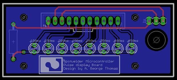

    I thought my first postwas clear when I said I was trying the double side design.
    My my last post has the ground pour on the top as well thereby avoiding a trace. The previous was without a gnd pour on the top so one side of the r1 and the gnd of vr would seen not connected.

    Why do you think you need to connect these points redundantly on both layers? One is enough.

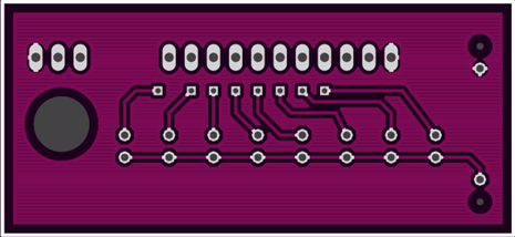

    But would that be only at the bottom ? there is nothing to connect on the top layer and I have no gnd pour on the top layer. Maybe this is what your trying to say

    You don't need that one trace in top layer, where all the points are connected by ground pour in the bottom layer.

    ok I think i get what you meant.

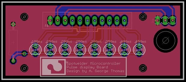

    the other goes to the ground. Should it have a via to the ground on the other side ?
    When the actual component is added wouldn't it be like inserted from the other side and the leads pop out the side we are looking at now ?

    The resistor has only one connection?

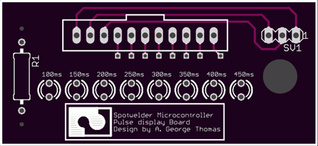

    Ooops missed that out. But would this be final ? Pot and leds go in the front the connector and resistor go behind is my what i have in mind.

    In the original you had all three vi connected across near the POT and now you have only two with the third open. Is that a mistake?
