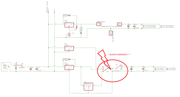

hello,
I started drawing in eagle this afternoon to make my first home made pbc board for a bench power supply that with an input of 12V/5A will have two output of 12V, 5V, 3.3V and an adjustable voltage (lm317)
the switches are these with ground in the middle
I hope that the schematic is clear (it is also in the attachments), maybe you could give me some hint or advice about something that i m doing wrong
about the .brd i didn't route it since maybe you will say me to modify my schematic
thanks in advance

    Hi,
    please check the detail with the amp-meter - its something wrong as I seen in the blockdiagram of the meter.
    Best Regards,
    Gerald

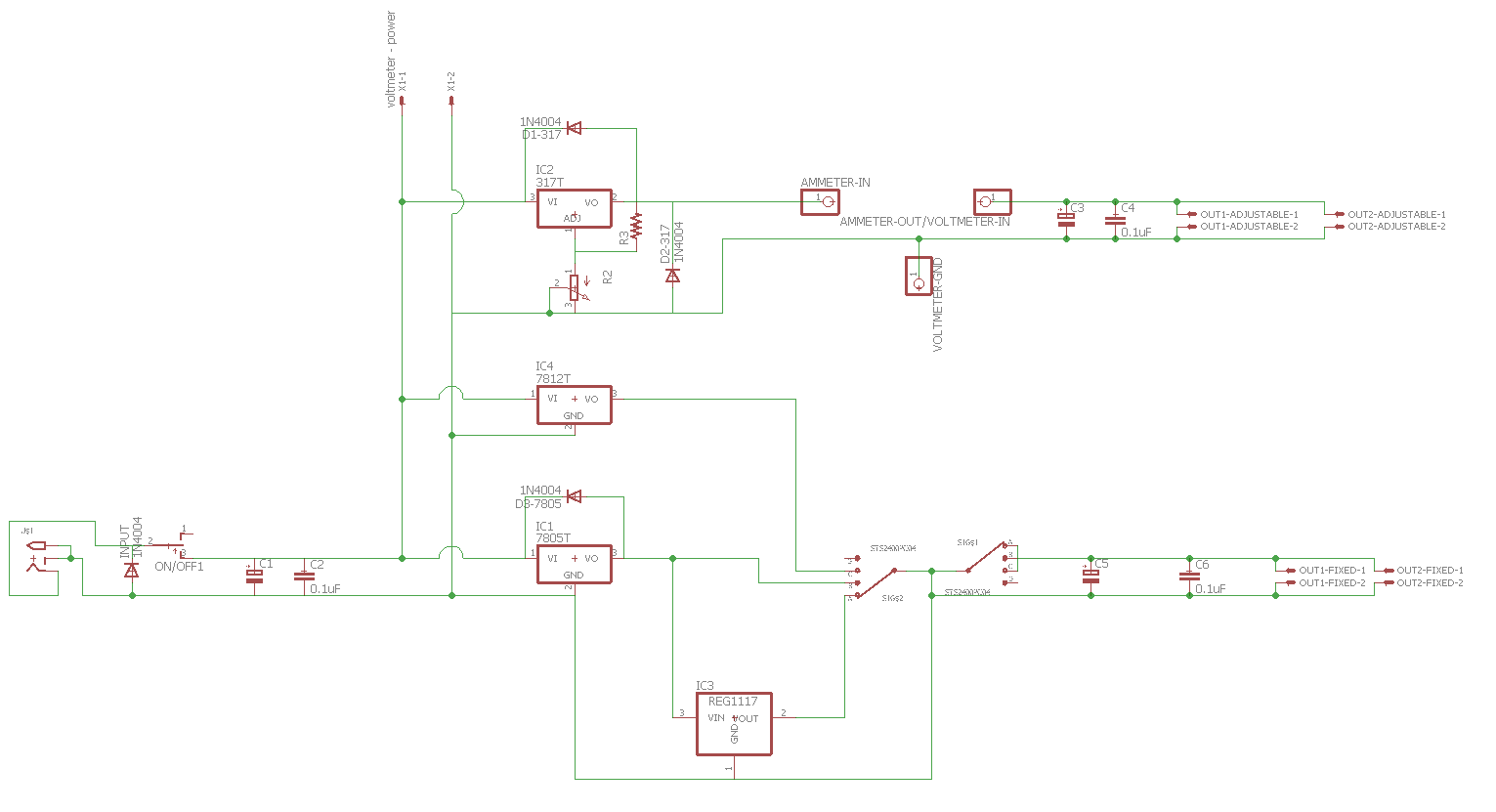

    board redesigned with:
    -added protection diode for 7812
    -removed slider switch
    -added ceramic cap for every IC
    -modified the wiring of the potentiometer
    i hope it is ok image

    0 geralds over 9 years ago in reply to aster94
    Hi,
    My pleasure.
    Please wait a bit for etching, because the circuit diagram has some fundamental errors.
    For example:
    ) The plug can not be used for 5A, at least only special types of plug.
    ) There is a better solution for polarity reversal protection, eg with a P-channel MOSFET.
    ) A filter (C-L-C at the input) should be inserted, especially bypass capacitors should be installed in the right places.
    ) The supply for the panel meter (V / A) I would solve differently (what kind of panel meter have you?).
    ) The switch at the output I would make with a rotary switch and relay, because the relay contacts can handle the current.
    ) The sliding switch described above is more suitable for signal currents.
    ) Or, even better, direct all outputs directly to the terminals, so you can use all outputs at the same time.
    ) The part with the LM317 should be modified.
    There was some hints for checking the schematic.
    Best Regards,
    Gerald

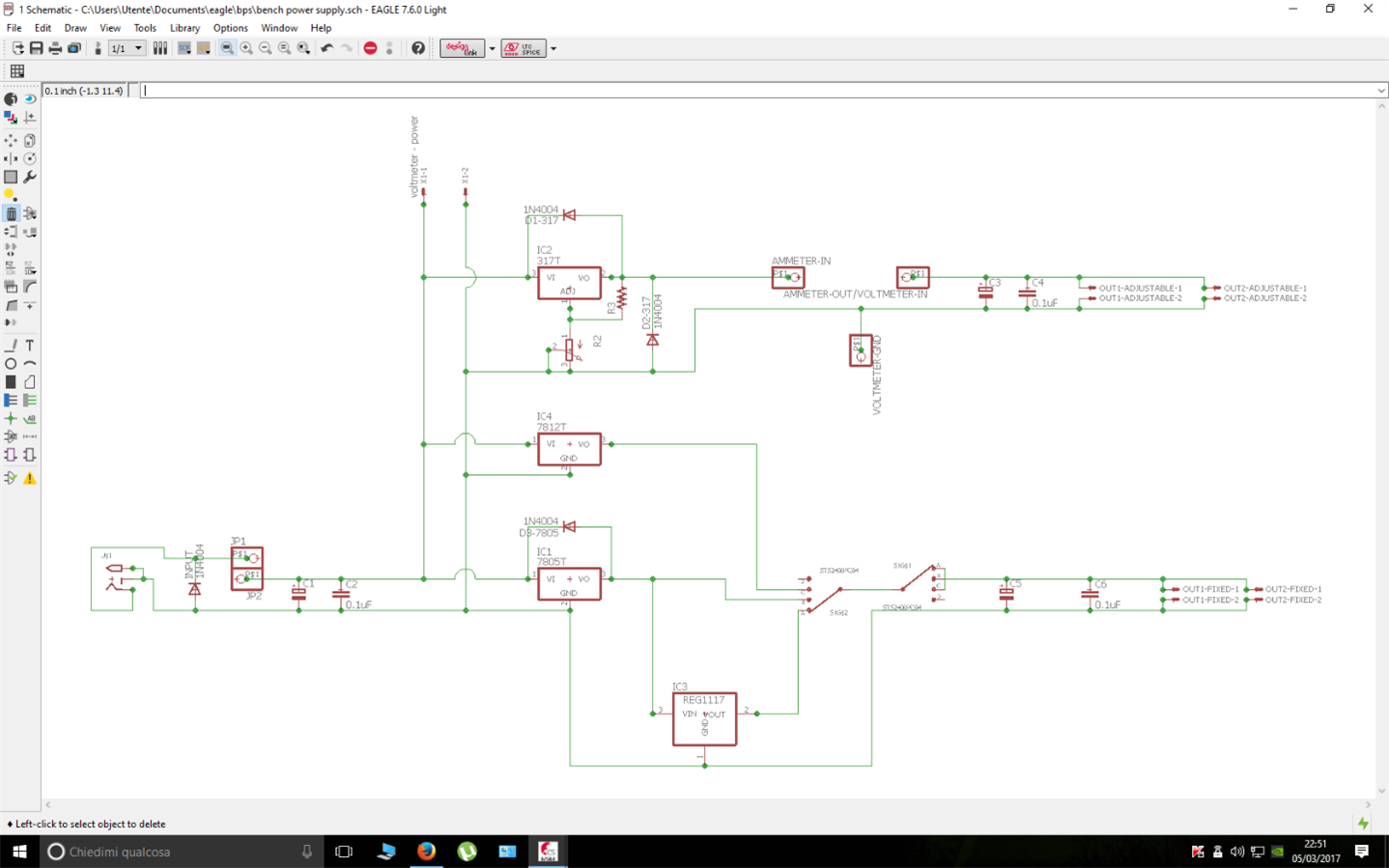

  • geralds
    Vincenzo Gibiino wrote:
    In your schematics the middle pin of the potentiometer is not connected, is it correct?
    Is this schematic also good?
    Hi,
    This is a symbol of a rheostat; An adjustable resistance.
    https://en.wikipedia.org/wiki/Potentiometer#Rheostat
    The difference between the rheostat and the potentiometer is that symbolically only two
    connections are connected, because here no voltage divider is necessary.
    So, a potentiometer is an adjustable voltage divider (% upper half //% lower half), a rheostat is not.
    For setting, one end (usually the "hot" end, maximum stop) and the slider are wired.
    (Usual, cold end = left, hot end = to the right of the stop, looking forward to the axis)
    This also has the disadvantage in the case of the adjustable resistance that when the slider is interrupted,
    e.g. by dust inclusions, or jumping, the entire resistance is interrupted.
    Therefore, the "cold end" of the adjustable resistor is also connected for safety reasons.
    Then, in the case of the interruption, at least the total resistance value has the connection.
    In this way, this circuit can still control, in this case only with the maximum resistance value.
    In the case of the rheostat, the regulation would fail.
    The schematic have fundamental errors (sorry).
    Best Regards,
    Gerald
  • aster94
    0 aster94 over 9 years ago in reply to geralds
    Gerald, i own you a coffe
    it was wrong since the first time i draw it and i never saw it... ops...
    now i think everythink is ok image tomorrow i will finish the .brd and than i will ask a friend who have all the etching stuff!
    thanks again to mcb1 and COMPACT, I would like to say that, as I wrote before, I don't have any tool (except the voltmeter at 3$), but I know that linear regulator dissipate the excess power as heat and that dc-dc regulator are more efficient. I am making this simple bench power supply just for hobby to improve my abilities, especially about the pcb making (drawing, printing, ectching ecc) and because sometimes I need one
    I looked on google for the S100, do you mean this:  http://www.s100computers.com/My%20System%20Pages/The%20Box/Linear%20Power%20Supply%20in%20Box.jpg  my first purpose is to do something on "my own", not to buy a ready to use one
    deliberately have polarised capacitors attached back to front or use capacitors beyond their rated working voltage
    mmm I will try if this is not a smart way to try to kill me image ahahah obviosly I'm joking
    here there is the -I think- last version, as you adviced I
    1. put the protection diode on the input
    2. changed the simbol for the imput since i will use a dc plug (I'm not sure if it is correctly wired)
    3. moved the ams1117 after the lm7805
    4. reduced the number of caps
    5. moved the voltmeter input
    6. added a lm7812
    the cap that i will use:
    C1- electrolytic 2,200 - 4,700 uF, 25V
    C2,4,6 - ceramic 0.1uF , 25V
    C3,5 - electrolytic 1/10 of C1 (i read it somewhere I don't know if it is correct), 25V
    next week I will start making the board, I attached the schematics and a really really first version of the board (i just put the component where they should be more or less), my goal is to make it single layer (since i am making it home), the sizes on the edges are the maximum that i could use image
    NOTE: in the board the first swith is not present because it will be on the front panel not on the pcb
