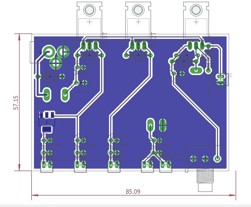

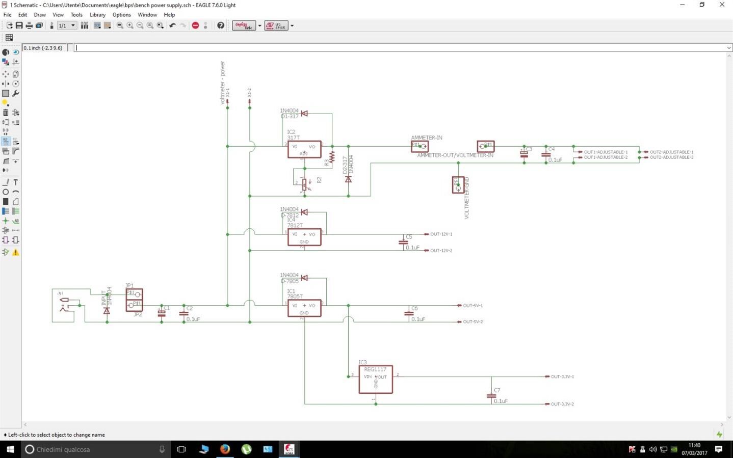

hello,
I started drawing in eagle this afternoon to make my first home made pbc board for a bench power supply that with an input of 12V/5A will have two output of 12V, 5V, 3.3V and an adjustable voltage (lm317)
the switches are these with ground in the middle
I hope that the schematic is clear (it is also in the attachments), maybe you could give me some hint or advice about something that i m doing wrong
about the .brd i didn't route it since maybe you will say me to modify my schematic
thanks in advance

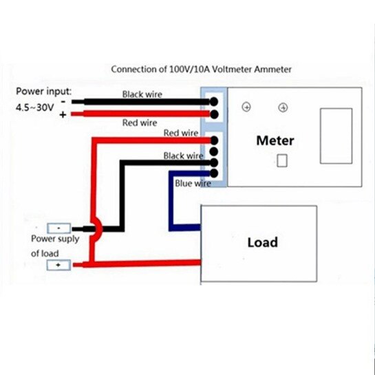

    Also a minor difference but if you can the voltmeter input should be on the Output of the ammeter.
    Most ammeters use a small resistance in series and measure the voltage across it to derive the current figure, some are negliglble but others are higher.

    0 COMPACT over 9 years ago
    I'd definitely put polarity protection at the input.
    Your original design also makes the assumption that you are feeding the board with 12VDC regulated. Is this the case?
    With a linear regulator you can't output 12V from an input of 12V.
    A linear regulator works on the premise that excess power is dissipated as heat but can't absorb heat to boost voltage.
    I suggest that you start with a prototype first and test it out to see if it meets your needs.
    1. with input protection.
    2. with a single output.
    Once this is working then add your bells and whistles.
    And once this has been done then layout your PCB with sufficiently sized copper traces.
    Make sure that the regulators are sufficiently heatsunk to dissipate the unwanted power keeping the regulator temperature within operating bounds.

    finally I'm back! looking a little bit around i found that the lm317 is not the best IC to use in parallel: LM317 in parallel - Answered -> LM2596 circuit question  so i will just be happy with its <1.5A
    i draw again the circuit with your precious suggestions:
    now i have the input of 12V filtered by a 1000uF electrolityc and a 0.1uF ceramic capacitators with:
    -"high" current output with the lm317 (i think that now it is correctly wired)
    -low current output where i could choose between 12/5/3.3 volts
    the ammeter/voltmater that i am using is this: https://it.aliexpress.com/item/1pcs-DC-100V-10A-Voltmeter-Ammeter-Blue-Red-LED-Amp-Dual-Digital-Volt-Meter-Gauge-Voltage… as i said before it's the same that jw0752 is using
    i think that i could start to draw the board, anyone have any suggestion?
    about the power supply from the 220V I was undecided between: https://it.aliexpress.com/item/Free-shipping-2pcs-lot-Power-adapter-EU-UK-AU-US-AC110-220V-to-DC12V-2A-led/1806497704.ht…  and https://it.aliexpress.com/item/New-24W-Regulated-Switching-Power-Supply-LED-Driver-Lighting-Transformer-For-LED-Strip-Li…
    the second one is far away better, isn't it?
    EDIT: i was thinking that maybe the ams1117 would stay in a safer position if i use the Vout from the lm7805, correct?
    EDIT2: instead of all these output caps (3,4,5,6,7,8) wouldn't be better if a just put a 100nF ceramic cap before every output? or do you think i will need more filtering?
