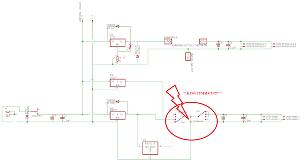

hello,
I started drawing in eagle this afternoon to make my first home made pbc board for a bench power supply that with an input of 12V/5A will have two output of 12V, 5V, 3.3V and an adjustable voltage (lm317)
the switches are these with ground in the middle
I hope that the schematic is clear (it is also in the attachments), maybe you could give me some hint or advice about something that i m doing wrong
about the .brd i didn't route it since maybe you will say me to modify my schematic
thanks in advance

    mcb1 over 8 years ago in reply to aster94 +2 suggested
    the rated current it is 0.5 at 50v so I could reach 2A at 12v It doesn't work that way. The current specifies how much the switch will pass without damaging the contacts. The voltage specifies how high…

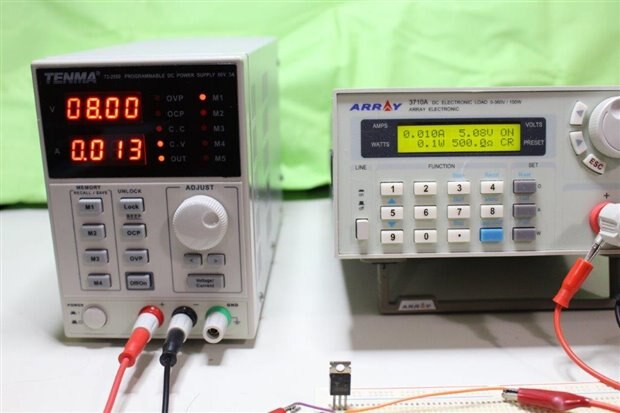

    0 COMPACT over 8 years ago in reply to mcb1
    Here is an example of what I mean.
    8V in from a regulated power supply being output as 5VDC using an LM7805 Linear Regulator.
    (The current limit has been set to 50mA on the bench power supply as not to risk melting the breadboard or voltage regulator without a heatsink.)
    The most important point here is that the circuit works!
    The test apparatus on the left is a TENMA bench power supply; it is a beauty of a unit and can be remotely controlled by a computer.
    The test apparatus on the right is a DC Electronic Load; it provides a test load for the regulator output whilst acting voltmeter and ammeter.
    If you look at the numbers on the apparatus; you'll notice that the input power used is greater than the power being output; the missing power is expelled as heat!

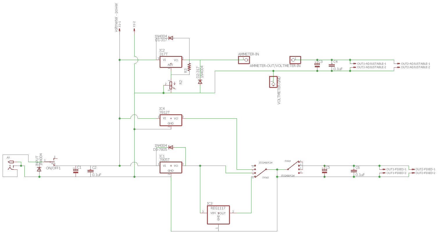

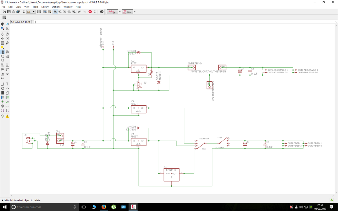

  • aster94
    0 aster94 over 8 years ago
    thanks again to mcb1 and COMPACT, I would like to say that, as I wrote before, I don't have any tool (except the voltmeter at 3$), but I know that linear regulator dissipate the excess power as heat and that dc-dc regulator are more efficient. I am making this simple bench power supply just for hobby to improve my abilities, especially about the pcb making (drawing, printing, ectching ecc) and because sometimes I need one
    I looked on google for the S100, do you mean this:  http://www.s100computers.com/My%20System%20Pages/The%20Box/Linear%20Power%20Supply%20in%20Box.jpg  my first purpose is to do something on "my own", not to buy a ready to use one
    deliberately have polarised capacitors attached back to front or use capacitors beyond their rated working voltage
    mmm I will try if this is not a smart way to try to kill me image ahahah obviosly I'm joking
    here there is the -I think- last version, as you adviced I
    1. put the protection diode on the input
    2. changed the simbol for the imput since i will use a dc plug (I'm not sure if it is correctly wired)
    3. moved the ams1117 after the lm7805
    4. reduced the number of caps
    5. moved the voltmeter input
    6. added a lm7812
    the cap that i will use:
    C1- electrolytic 2,200 - 4,700 uF, 25V
    C2,4,6 - ceramic 0.1uF , 25V
    C3,5 - electrolytic 1/10 of C1 (i read it somewhere I don't know if it is correct), 25V
    next week I will start making the board, I attached the schematics and a really really first version of the board (i just put the component where they should be more or less), my goal is to make it single layer (since i am making it home), the sizes on the edges are the maximum that i could use image
    NOTE: in the board the first swith is not present because it will be on the front panel not on the pcb
    bench power supply.zip

  • geralds
    0 geralds over 8 years ago in reply to aster94
    Hi,
    please check your circuit!
    Best Regards,
    Gerald

  • aster94
    0 aster94 over 8 years ago in reply to geralds
    Gerald, i own you a coffe
    it was wrong since the first time i draw it and i never saw it... ops...
    now i think everythink is ok image tomorrow i will finish the .brd and than i will ask a friend who have all the etching stuff!

  • geralds
    Hi,
    My pleasure.
    Please wait a bit for etching, because the circuit diagram has some fundamental errors.
    For example:
    ) The plug can not be used for 5A, at least only special types of plug.
    ) There is a better solution for polarity reversal protection, eg with a P-channel MOSFET.
    ) A filter (C-L-C at the input) should be inserted, especially bypass capacitors should be installed in the right places.
    ) The supply for the panel meter (V / A) I would solve differently (what kind of panel meter have you?).
    ) The switch at the output I would make with a rotary switch and relay, because the relay contacts can handle the current.
    ) The sliding switch described above is more suitable for signal currents.
    ) Or, even better, direct all outputs directly to the terminals, so you can use all outputs at the same time.
    ) The part with the LM317 should be modified.
    There was some hints for checking the schematic.
    Best Regards,
    Gerald

  • aster94
    at the end i will just use 1.5A, i think it would be able to handle them (wikipedia says 2A)
    I am an hobbyist making my first power supply, I would like to do something veeeery simple, i found these solution on google and they don't seem to difficult to apply: https://forum.allaboutcircuits.com/threads/pi-filter-clc.2687/ and http://lh4.googleusercontent.com/-uZWaEG-Yhn4/UAXdcxfPDLI/AAAAAAAAET0/SWL6YD6HwYg/s398/input-protect.png  so I would go with your better solutions for my next board but for now i will just use the two capacitor for filter the input
    this: https://www.element14.com/community/external-link.jspa?url=https%3A%2F%2Fit.aliexpress.com%2Fitem%2F1pcs-DC-100V-10A-Vol…
    at the end i think that i would do as you and COMPACT said,having all outputs free is better
    For setting, one end (usually the "hot" end, maximum stop) and the slider are wired.
    (Usual, cold end = left, hot end = to the right of the stop, looking forward to the axis)
    I am not sure to have understood where the problem is: do i just need to invert the hot and cold end of the pot?
    edit: added new shematics at the end of this topic
