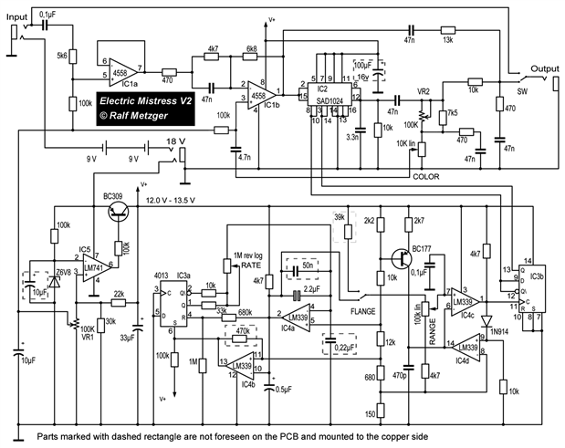

I'm after a SAD1024 delay chip, they were manufactured by Reticon and are now discontinued, and have been for around 30 years. I'm hoping someone here may have one lying around....... if so can you get back to me and I'll make you an offer to buy it off you.
As a heads up this is required for a planned pedal build, for the near future, but it all rests on being able to obtain this IC chip.

    The really hard part about exact replication is that the BBD (Bucket Brigade Delay) device varies its sampling rate as the clock changes and the clock in the flangers is swept. This means that data is sampled at one clock speed but then passes into the delay chain and may be sampled at the output at a different rate from that at which it was captured.
    Typical ADC - DSP- DAC chains sample at  a constant rate and will have serious issues if swept sampling is attempted (and only ultra pricey parts can go fast enough). It is possible to achieve the entire effect with constant rate sampling but the DSP will be required to interpolate and resample at both input and output and I would guess that an audio sample rate of 192kHz will be needed to come close to the behavior of the SAD1024. This kind of DSP stuff is possible with DSP chips or FPGA (@ DAB - way out of PSOC league). The development effort in software is significant (if I were quoting a customer I would allow 8 weeks for the FPGA HDL work).
    The other way to do it is to use a non-conventional chain with SAR ADC and ladder type DAC where the sampling is on demand with negligible latency. 16 bit 2MHz parts will be needed to match the SAD1024 dynamic range and speed. The FPGA needs to do very little other than buffer the data (needs 2k bytes of internal RAM so a Lattice ICE40 series part would do - and would keep the power low.
    The problem is that the 16 bit 2MHz ADC and DAC are quite expensive.

    0 jc2048 over 9 years ago in reply to shabaz
    I don't know much about musical stuff, but from that circuit I'd say that the flange effect comes from sweeping the clock up and down in frequency.
    The 470p being charged by the transistor (set up as a current source) and then being reset by the comparators is evidently the actual clock. The period of that clock is determined by the slower triangle waveform generated by IC4a (the 22u integrates up and down depending on the state of the flip-flop IC3a, which flips backwards and forwards in the way that flip-flops like to do).
    Unless you could simulate that I don't think you would have flanging, though you'd be able to do other interesting stuff with it.

  • Andy Betts
    0 Andy Betts over 9 years ago in reply to michaelkellett
    Hi Michael
    Yeah, I know small bear... US supplier, and expensive to get shipped over to the UK.
    The circuit is attached
    From what I understand, the SAD1024 is pretty peculiar to this circuit, however if there's a good substitute I'm willing to look into that.
    Original SAD chips are expensive, for that very reason....... They are gold
