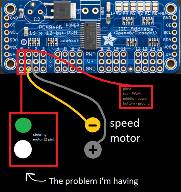

So I saw a neat project on a magazine about controlling an rc-car wirelessly through a raspberry pi, using pwm.

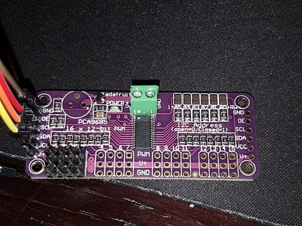

I ordered everything I needed, mainly an i2c controller, and I started working on it. i am using a clone of the adafruit controller instead of a real one, because it was a lot cheaper, though the functionality remains the same.

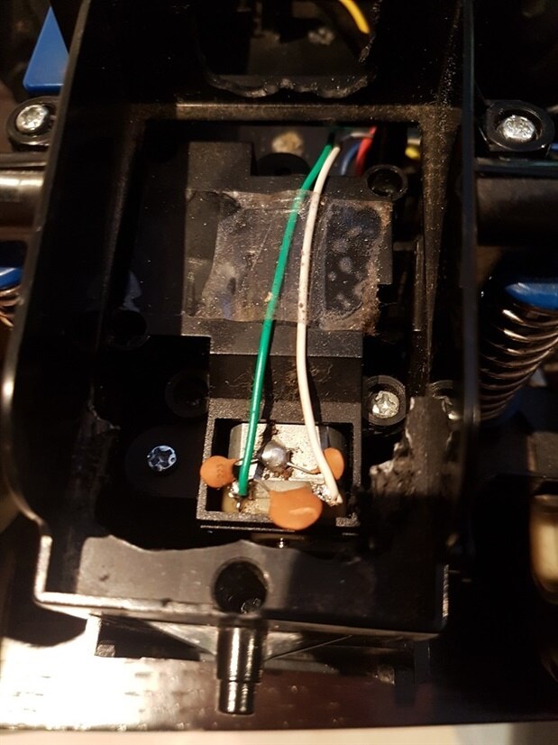

Now, I have a problem. The article says that I need to connect the steering motor to the 3 pins on the adafruit controller, which are labeled power, ground, and PWM, but my motor only has two wires, so I have no idea what they do, or what to do next.
I do not have another rc-car to do this on. How do I connect the motor to the controller? do I need to get a different motor?
Thank you for your help!

    I have also experienced taking a rc car apart to find this type of 6V motor for steering control. It is not as precise as a servo. If this is the only option for your project then I would recommend a L293D or L298N Dual H Bridge Motor driver. This will handle the 6V steering and drive motors on this car.
    This will be easier than replacing the steering motor with a servo.
    The 16 channel pwm/servo driver that you have purchased is a good part for a hexapod type robot or robotic arm. With this part you could include a servo controlled arm or a camera gimbal into your project. This pwm/servo driver might also be used to control RGB LEDs.It might also be possible to use this driver to control the esc on a quadcopter drone. Even if you can't use it with your current project, it might come in handy for a future project.
    dougw over 8 years ago in reply to tlucas756
    The servo needs the rest of the internal circuitry to work like a servo. If you just use the motor, you will need the H-bridge just like any other DC motor.

    The L293D h bridge will drive this type of motor. It is a very low cost part (US $2). The PCA9685 is for use with servos although as mentioned a circuit can be created. The cheapest and easiest option would be to purchase an L293D h bridge.

    I was planning on tearing the motor apart and only salvage the motor itself, because the assembly of the motor in the car already has the gears inside.
    Though, if I'm gonna do that, I'll just get the cheaper one, since I won't be using the metal gears

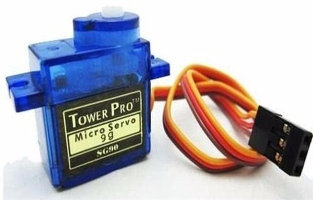

    beacon_dave over 8 years ago in reply to tlucas756
    Adafruit appear to approve of them:
    https://www.adafruit.com/product/1142
    "We now carry the Tower-Pro MG-995, they are very nice, high quality servos, excellent for use in robotics."
    The question is probably more a case of can you fit it into the car in place of the existing steer motor ?
  • tlucas756
    tlucas756 over 8 years ago in reply to dougw
    would this one work? it does have metal gears.
    YOURobot - Servo Motor Tower Pro MG995

    beacon_dave over 8 years ago in reply to dougw
    There appears to be a metal gear version of the micro servo:
    https://www.adafruit.com/product/1143

    As Dave indicates a DC motor would need an H-Bridge to reverse polarity.
    The micro servo might work as a demo but may have problems in actual use. You need to check if the torque is enough, the speed is adequate, and the angle of rotation is sufficient.
    If all of that is okay, the wheels can typically transmit a high spike load to the motor when one wheel hits a bump or a wall. This will often strip the plastic gears in a servo motor. Servo-savers can reduce the spike load, but it may still need metal gears.
    Yes, that should work with the Adafruit PWM servo controller.
