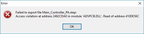

Hello!
I have some step file export fail.
I have never had this issue before. What should I do now?

    Actually not only a step file export does not work but also all export ends with crash. A reinstall of a CS does not help.
