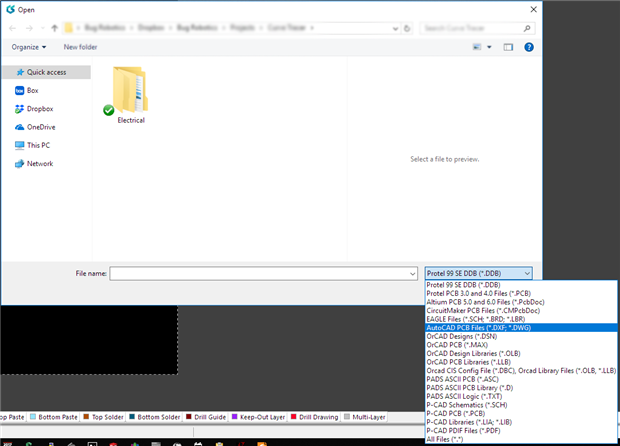

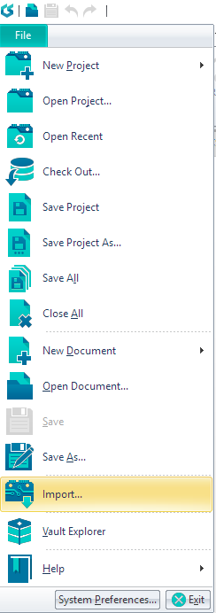

    1. Select "File" - "Import"
    2. Select "AutoCAD files" from the file type dropdown menu.  Browse to the DXF file you would like to use.

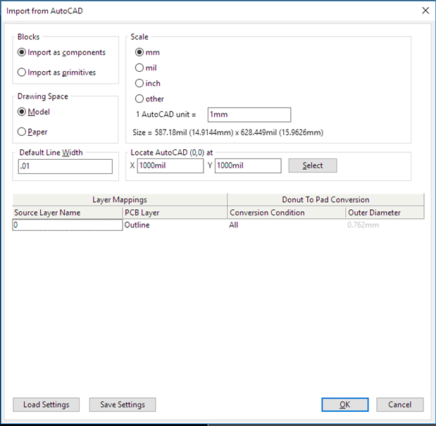

    3.  After selecting the file you need to configure the import settings.   Use the size to judge the correct Scale.

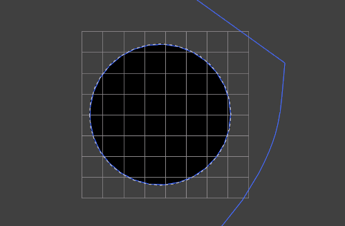

    4. The DXF will appear on the screen.  Highlight the area you would like to use for your board shape and select "Board Shape" - "Define from Selected Objects" in the ribbon toolbar.
    5.  Your board shape should be defined by the DXF outline you selected.
    Hope this helps.
