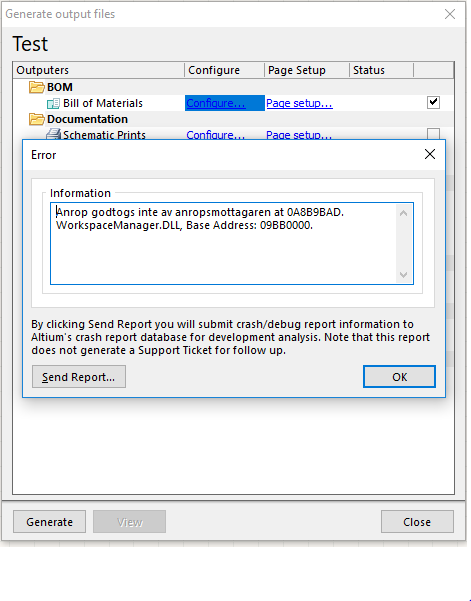

I have an annoying problem for which i need to find a solution quickly.
I cannot generate BOM on any of my existing or new projects. When I try to generate the bom or click "configure" I get the following error:
I recently moved from a win7 x64 system and have never experienced the problem on that machine.
Currently I'm running CS 1.4 on a win10 Professional X64 system. Could this problem be OS related?
I have tried reinstalling 1.4 version and also tried removing all preferences using the built in uninstaller but the problem remains.
I have just purchased an additional license renewal but the delivery time of 2-3 days for a license is a joke...
Any ideas on how to fix this issue would be much appreciated. Thanks!

    Have you got Microsoft Office (32-bit) installed on the new computer? Is it possible you had it on your old computer but not on the new one?

    Hi Peter,
    problem is I cannot export to any format. I get the error message shown in the first post immediately when i press the configure button.
    I also get the same message when i press generate.
    This is becoming a big problem as I have now spent several days trying to fix this issue and I have several boards where i need to send out the BOM.
    Any idea on how to get in touch with altium directly to solve this?

    Hi Mats. I will ask someone from Altium to make contact. It may help if you could update your post because what I presume would be a picture of the error message is not included or does not show. Knowing more details of the error would be helpful.

    Thank you,
    you cannot see the screenshot in the original post?
    What about now?

    Over the weekend I got chance to try CS on a brand new installation of Win 10 Pro 64-bit (an ISO for October update from memory) that did not have MS Office installed (no office suite of any type). I was able to export a CSV BOM, in my testing I actually did this from the BOM Configure and then Export option.

    Hi Peter,
    I have now tried uninstalling office365 and this "solves" the problem. I do no longer get the error message and is able to export the BOM in .CSV or .TXT
    When i reinstall office365 32-bit or 64-bit the problem comes back.
    So this is not a fix since i need to have office and CS installed all the time but at least I know CS seems to have a problem with Office for some reason.
    Any ideas on what could fix it?

    Finished testing and I'm sorry to say it seems to work perfectly. Generated an Excel BOM using BOM Simple.XLT template from example project PCI Express 4 Port Serial Interface. Installation order was CS followed by Office.
    • CircuitStudio 1.5.1 (Build 13)
    • Windows 10 Pro 64-bit, Version 1809, OS build 17763.107
    • Excel for Office 365 MSO (16.0.11231.20164) 32-bit
    A couple of suggestions:
    • Delete (or move to another folder) your own OutJob file and then try configuring and generating BOM again
    • Try using the example project as I did above

    After investigating further I started uninstalling one program at a time until I got it working.
    It turns out it was kutools addon for excel that was the cause of this problem (at least i think so)
    Now Bom generation works again. Thanks for the time invested in this case.
