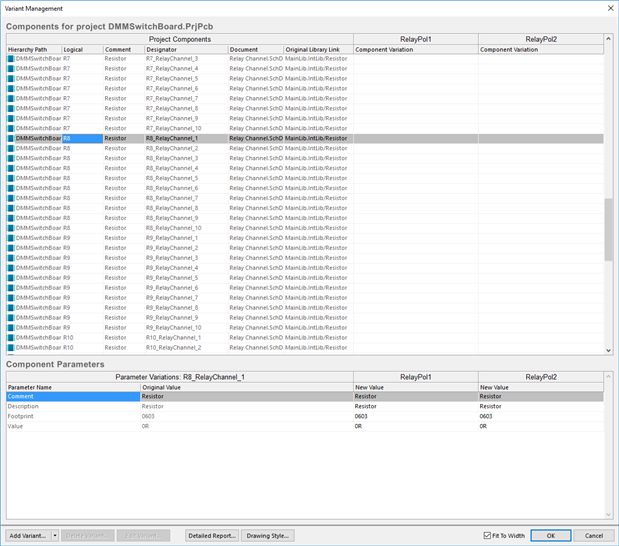

  • harvie256
    harvie256 over 9 years ago in reply to e14softwareteam
    Could you tell us which version of Altium Designer the Variants feature is based off?  They are discussed here: Multi-Channel Support for Variants | Online Documentation for Altium Products
    I used it on a recent design involving a multi-channel schematic (it's actually open source, you can see it here https://forum.makehackvoid.com/t/open-hardware-multi-meter-scanner-card/1024 )
    However, once I place the schematic sheet symbol on the top level schematic and used the Repeat command, all the components tagged to the variant disappeared from the variant manager.  What it's been replaced with is a separate  component for every channel of the design without the Not Fitted aspects in each variant (hopefully that made sense!)
    Does this mean it's actually the very early version of Altium's "Variants" that is incompatible with multi-channel designs?  Or am I doing something wrong?
    For example all the R7's and R9's should be Not Fitted in the capture below.
  • e14softwareteam
    e14softwareteam over 9 years ago
    From the developers:
    When the repeat statement is used there are more physical components on the PCB so the Component Links command shows many more links between each channel and each PCB component.
    Therefore each one of these component instances needs to be setup in the Variant Management dialog.
  • harvie256
    So the answer the question I asked... No Circuitstudio does not support multi-channel Variants like Altium Designer has for the last few generations.
    That's a shame, I use hierarchical multi-channel schematics all the time, so looks like variants is a no go.
    Perhaps the online documentation should be updated to make it clear that it requires manual intervention if you want to use them together.
