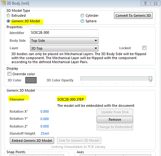

    I've just spent an age trying to modify a design by a chap who recently left the company.
    All I want to do is move a new step model up and away from the PCB (in the z-axis). Can I do it? Nope. There are numerous parameters like 'Standoff Height', 'Overall Height', none of which do a thing. The documentation says you can adjust an extruded part, but no mention of step models.
    I've used Ultimate, PADs and Expedition and despite all their failings, none are as annoying as this package. To make matters worse, a lot of the help directs you to Altium Designer which I suspect is deliberate to ween you off this poorer software.
    Is it possible to raise or lower a component or must we shift the coordinates in the 3D software and then reimport?

    "Standoff height" under the axis rotation options should do it. I assume it will just move the model relative to the vertical direction of the PCB, I model most of my own models so they already use "z" as the vertical axis, presumably you are in "generic 3D model" as each different 3D option has it's own set of options.

    I have tried entering values for everything I can find related to depth position to no avail. z this, z that, standoff, height, everything. I've tried this in both the library editor and for the numerous component options/properties and in Manage 3D Bodies. Nothing moves the part. All I want is to shift the z axis origin for the model, but it would be too easy to have a simple box for that.

    To lift a component off the board surface at the PCB level you change the standoff height in the 3D Body parameters window.  Make sure the part is not locked in place also.  Another way to do this is to select the step model and use the PCB Inspector panel.  Then change the Model Z property.  This works for me anyway.

    If you have imported a step model and are trying to change it then I think you may be doing something wrong based on the options you describe for manipulating the position of the model. If you have a step model you should get the following dialog options, options you mention like overall height are not part of the properties for step files (they are for extruded though).
    Turn on the 3D Top layer and you should see shaded areas where the step model sits. In 2D mode double click the model and it will bring up the dialog to adjust the body.
