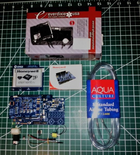

The Test configuration for testing the Honeywell sensors and SEK002 include the following:
Hardware
Cypress PsoC 6 BLE Pioneer Kit (CY8CKIT-062-BLE)
https://www.element14.com/community/roadTests/1862

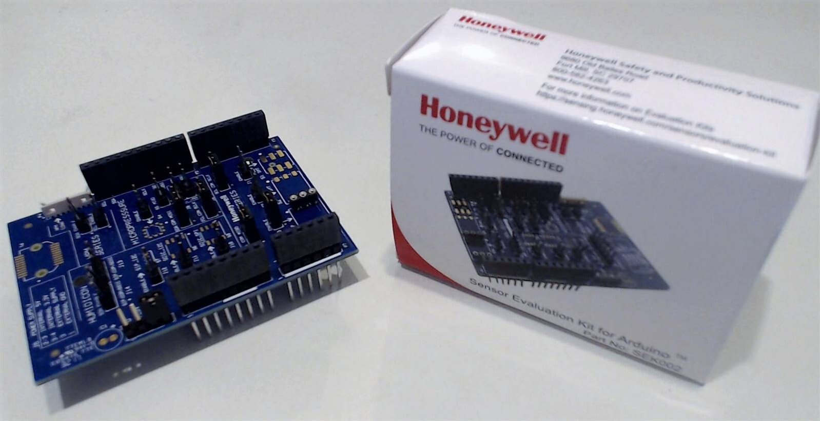

SEK002
https://my.element14.com/honeywell/sek002/eval-kit-board-mount-pressure/dp/2849208
MPRLS0015PA0000SA - Pressure Sensor, 15 psi, Digital, Absolute, 3.6 VDC, Single Port, 1.7 mA
https://uk.farnell.com/honeywell/mprls0015pa0000sa/pressure-sensor-digital-15psi/dp/2811407?st=MPRLS0015PA0000SA
For the ABP type,
ABPDRRT005PG2A5 Pressure Sensor Amplified 5 psi Digital Gauge 5 VDC Dual Radial Barbed 3.7 mA
https://uk.farnell.com/honeywell/abpdrrt005pg2a5/pressure-sensor-5psi-radial-barbed/dp/2490463?krypto
HIH8120-021-001 - Temperature and Humidity Sensor, HumidIcon Series, Digital, 0% to 100% RH, 2 %, SIP, Filter
https://uk.farnell.com/honeywell/hih8120-021-001/humidity-temp-sensor-digital-sip/dp/2356756?st=HIH8120-021-001
Mini Air Pump Motor Model : KPM12A
YOOTOP 2Pcs DC3V Mini Air Pumping Motor Tank Oxygen Circulate Pump Replacement Accessories for Aquarium DIY Projects
Solenoid Electromagnet Valve
Uxcell a14010700ux0271 Uxcell
Flexible Tubing
Penn Plax Airline Tubing for Aquariums –Clear and Flexible Resists Kinking, 25 Feet Standard
Dixie Ems Deluxe Aneroid Sphygmomanometer Blood Pressure Cuff, Black
Sold by: BP MEDICAL SUPPLIES
2 x TIP120 for powering Valve and Pump.
2 x 10k Resistors
2 x 1N4004 diodes
LED and 330 Ohm resistor for Light indicator

Honeywell SEK002

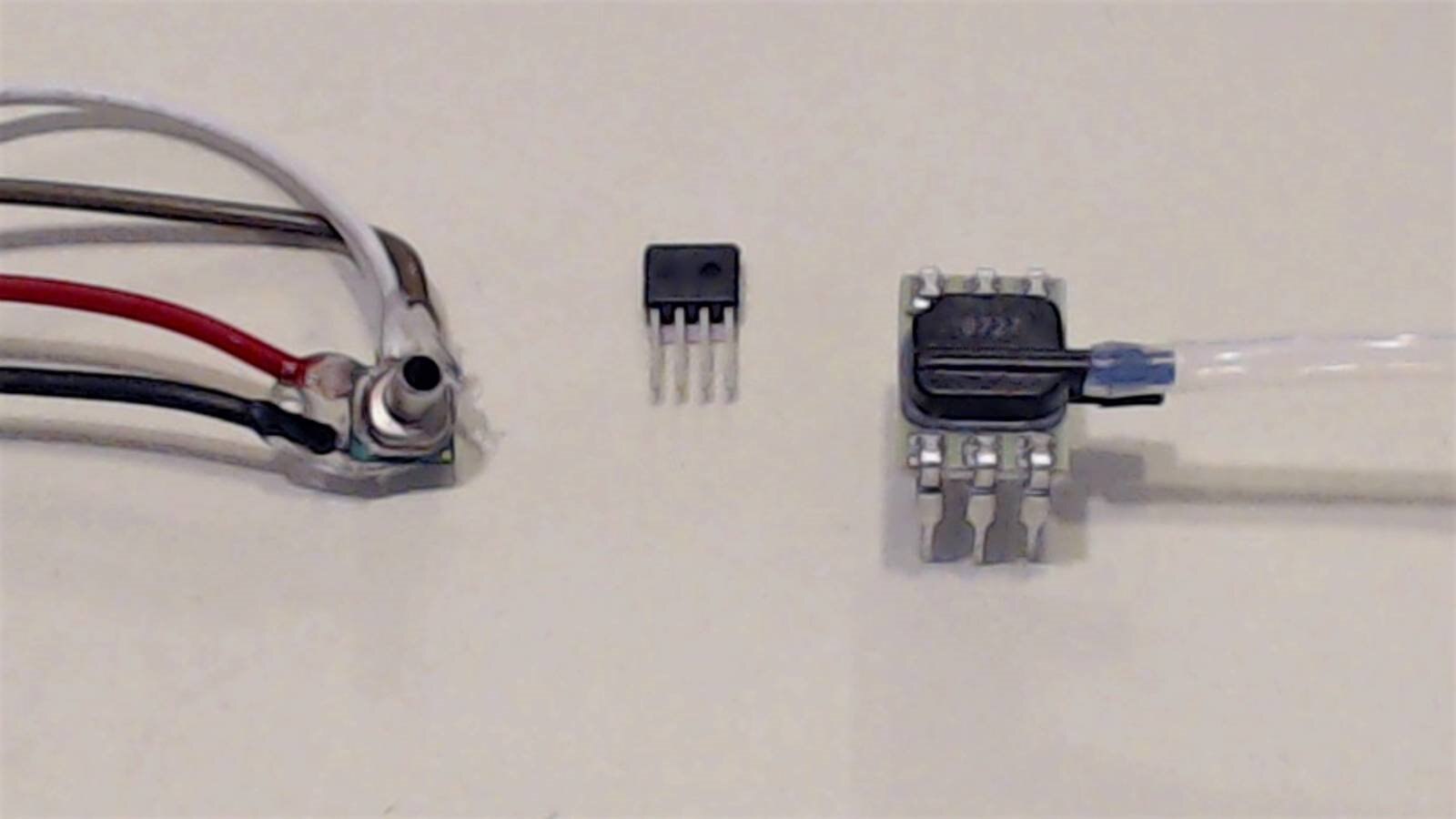

Honeywell Sensors
  • Sensors Shown
    Left to Right
    • MPRLS0015PA0000SA - Pressure Sensor
    • HIH8120-021-001 -  Temperature and Humidity Sensor, HumidIconTm Series
    • ABPDRRT005PG2A5 -  Pressure Sensor, Amplified, 5 psi

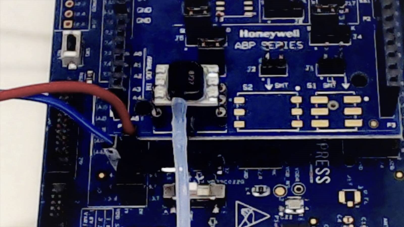

          ABPDRRT005PG2A5 -  Pressure Sensor, Amplified, 5 psi mounted on SEK002 which is mounted on the PSoC 6 BLE Pioneer Kit.

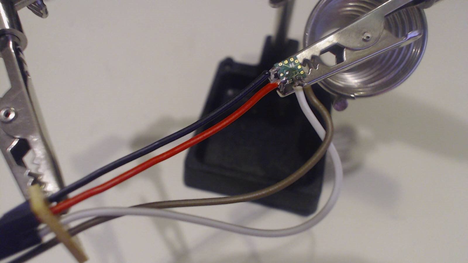

Attempt to solder wires to MPRLS0015PA0000SA - Pressure Sensor. This sensor is very small and really is intended for surface mount placement.
This was a bit of challenge to do with a standard soldering iron, but after a bit I was able to get it to stick.  After soldering the wires, I covered the connection with hot glue in hopes that the wires would not pull off.

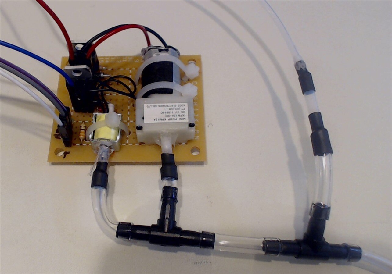

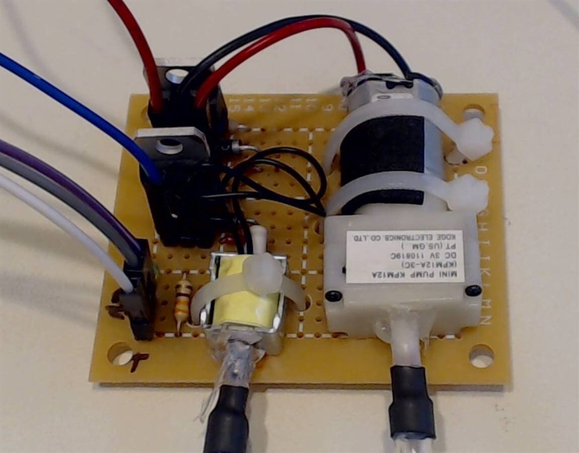

Mini Air Pump and Solenoid Electromagnet Valve with TIP120 for powering devices
Mini Air Pump and Solenoid Electromagnet Valve tube connections.

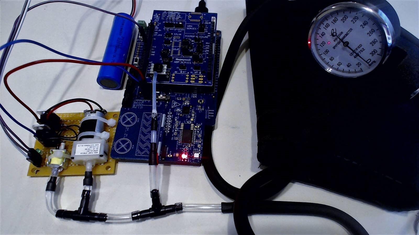

Pump assembly connected to PSoC 6 BLE Pioneer Kit with SEK002 and  Pressure Sensor, Amplified and ARM cuff with 3.7 volt Li-Po for power. The Li-Po is used to power the Pump and the Valve assembly and the board was powered via USB Type-C during development and debug. When the test is run, the pump will start inflating the bladder in the cuff and once the pressure value read by the Honeywell Pressure sensor gets to 1, the pump stops and the valve engages releasing the air.
