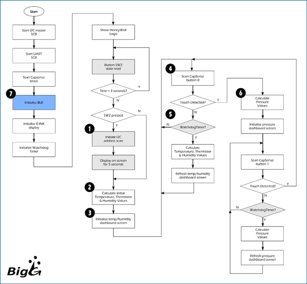

In part 1, I set out my PSoC 6 project application workflow, which set out 7 key steps to completing the PSoC 6 firmware that would read humidity, temperature and pressure sensor data and display this data periodically on the eInk display shield as well as provide a BLE bridge to allow this data to be transferred to another device. Here is that workflow again:

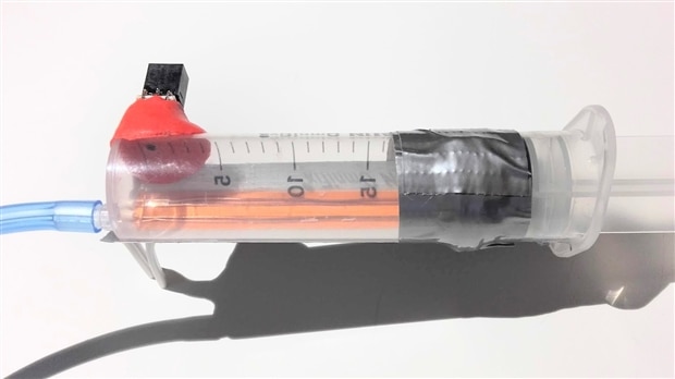

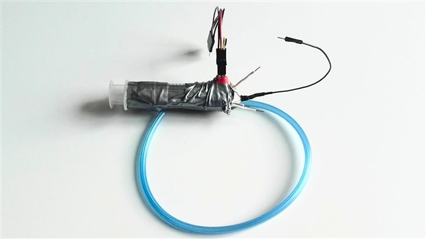

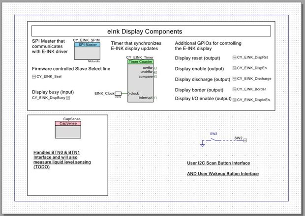

What is not covered in my project application write-up is the capacitive sensing part.
{gallery:autoplay=false} My Liquid Level Prototypes
This proved more of a "design challenge" for me, as I have never designed a liquid level sensing application before.
As I did not have the correct material to create the right capacitive sensing "pads" using copper strips or foil (or conductive ink), I tried single core copper wire instead, but my initial test apparatus failed to show anything of value. So, I decided to park this part of the project for another day.
One thing that did work was my aluminium foil shielding, which is under the duct tape (see picture). When I held the syringe no change in capacitive readings were detected - I used the PSoC Creator Capsense Tuning Tool for this test.

PSoC 6 Project Overview
Thanks to Cypress Semiconductor there is a great range of PSoC 6 examples to work with.

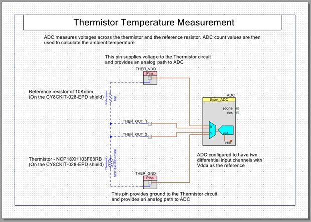

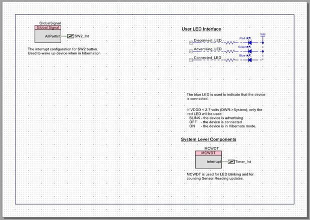

I have incorporated different code snippets within my project, such as the BLE callback function, watchdog timer routine, eInk display (EPD display shield), temperature measurement from the EPD display shield thermistor, CapSense button detection and various other user interface routines such as LED control and SW2 wakeup.

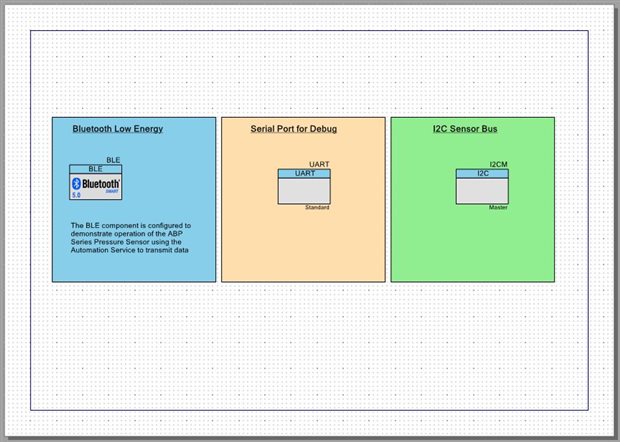

{gallery:autoplay=false} PSoC Creator Top Level Design View

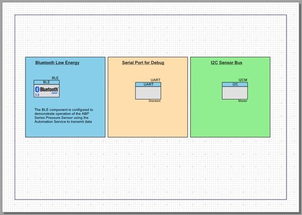

Top Level PSoC 6 Design.

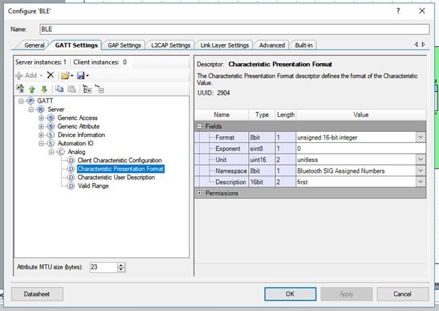

Let's start with the Bluetooth 5.0 component.
Here we have it set up as a peripheral device. It is using both of the PSoC 6 cores. CM0+ handles the BLE interrupt timer and CM4 handles the logic for the defined profiles and exchange of information.

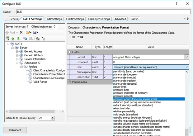

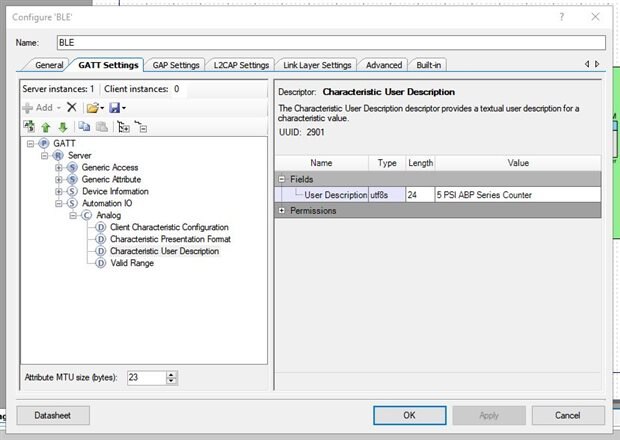

The BLE component acts as a GATT server and we have defined an Automation IO service (0x1815), which exposes an Analog characteristic (UUID: 2A58). For this characteristic I chose to use the NOTIFY property only. The Automation IO service also uses the Characteristic Descriptors to define what the Analog value means. This is very useful for information exchange between the central device and the peripheral device.
{gallery} Automation IO Characteristic Descriptors
For the purposes of my application, I defined my units as "unitless" (to make it simpler for my smartphone app - I transmit the raw 16bit value), but I could easily have defined the correct units and then transmitted the actual pressure value (note that for float variables this requires a specific conversion technique).
Moving onto the UART component.

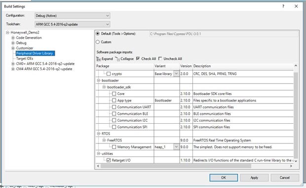

Here I followed this Cypress Semiconductor tutorial: https://www.youtube.com/watch?v=ZJOF2f423nI
This tutorial provides guidance on how to use "printf" by enabling the "Retarget I/O" option in Build settings and then amending the shared "stdio_user.h" file to define the UART port.
For the I2C Sensor Bus, we include a I2C Master component.
Not much needs amending here. In my case I used the 100kHz as my data rate (I could have used 400kHz).
Other Code modules

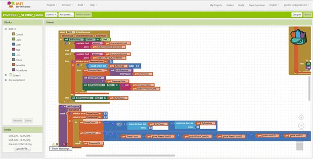

Smartphone BLE App
For the Bluetooth Low Energy bridge, I created a smartphone app, using MIT AppInventor as I was able to use an old project of mine, which is listed on Hackster.io.
I have attached my PSoC 6 Code and I have uploaded my the MIT Appinventor project onto Github (as the Element14 website will not accept as an attachment) for those who want to look at and/or use.
