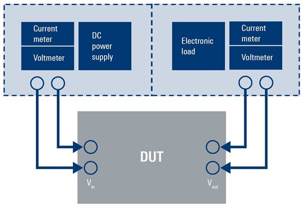

Measurement setup
The R&SRegisteredNGM202 and R&SRegisteredNGL202 provide great functionality and performance to measure, evaluate and optimize the important DCDC converter efficiency with just one instrument. The two-quadrant architecture allows them to function both, as a source and sink to provide highest flexibility. The highly precise read-back measurement capability for voltages and currents at the input and output offers the designer a very simple solution where only one device is required to measure the efficiency. The efficiency measurement setup of a DC-DC switching converter hence only consists of the power supply and the DUT connected to the two channels. Optional remote sensing connections increase the accuracy at higher currents.
Channel 1 is configured to work as a constant voltage source that supplies the converter with the required voltage and current (source). Channel 2 is configured to operate as a load in constant current mode (sink) to load the converter with a valid operational current based on the converter specification. A reasonable overcurrent protection level of the source as well as the prevention of the DUT’s overcurrent detection need to be considered in the configuration of the device. The voltage and current at the input and output are measured internally, and therefore the input and output power can be calculated and displayed on the screen.

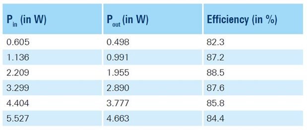

Efficiency measurement at different load settings
The efficiency measurements at different load conditions shown in the table below indicate that the converter is already an efficiency-optimized converter. The R&SRegisteredNGM202 or R&SRegisteredNGL202 let you determine the efficiency of your individual circuitries and layouts. This means that in addition to going through the discussed optimization process to improve efficiency, the designer has to perform multiple measurements to validate the efficiency under all circumstances. This effort can be reduced tremendously by using the remote control functionality that allows to automatically create efficiency traces with an external script and a piece of software.

    Unfortunately it is not yet possible that NGM202 resp. NGL202 can do the calculation. However, automated measurements with different load points are possible with a script. A sample script can be found on our website.
    Jan Cumps over 6 years ago in reply to baldengineer
    baldengineer  wrote:
    Normally when I think of efficiency measurements, I think of using an oscilloscope. Can the NGM202 and NGL202 do the calculation for me, reducing the need for a scope? What about automating the measurement at different power/load levels?
    These devices where one channel can source power ( PSU) and the other channel can sink power ( load) can calculate efficiency.
    Because the power delivered by the PSU - the power consumed by the load == loss.
    I've used separate PSU and (self made) load in a DC converter road test. This one can do this in a single module.
