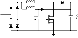

Recently one of our salespeople emailed me stating that in an off-load condition, his customer could hear a 10 kHz hissing sound coming from one of our 60W output power supplies and was curious if the unit was faulty.  Normally I would have asked about capacitive loading conditions or if the product was being grounded correctly.  Remembering the briefing I checked the product specification for no-load power draw.  Seeing that it was a low 200mW, I talked to one of our Design Engineers.
Before Energy Star legislation came into force, power supplies would often draw 5, 10 or even 20 Watts when in a no-load condition.  Apparently this was accounting for about four percent of the total electricity used in the US.  Now most small power supplies will draw less than 300mW.  Although the legislation is aimed at consumer products like phone chargers, many industrial customers are now requesting similar energy saving products.
I was informed that many of the new power supply control chips employ advanced energy saving features, and what my customer was hearing was probably the converter going into “burst-mode”.
AC-DC power supplies above 70W will often have two converters in them; one is the boost PFC (power factor correction) converter which ensures that the input current is not drawn in big “gulps”, but more sinusoidal like the applied AC voltage.  An interleaved PFC converter shown below is used for this purpose.

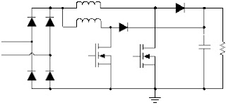

The other is the main switching converter which chops up the high voltage DC from the PFC section and provides isolation, voltage step down regulation and filtering.  A commonly used “half bridge” circuit is shown below.
